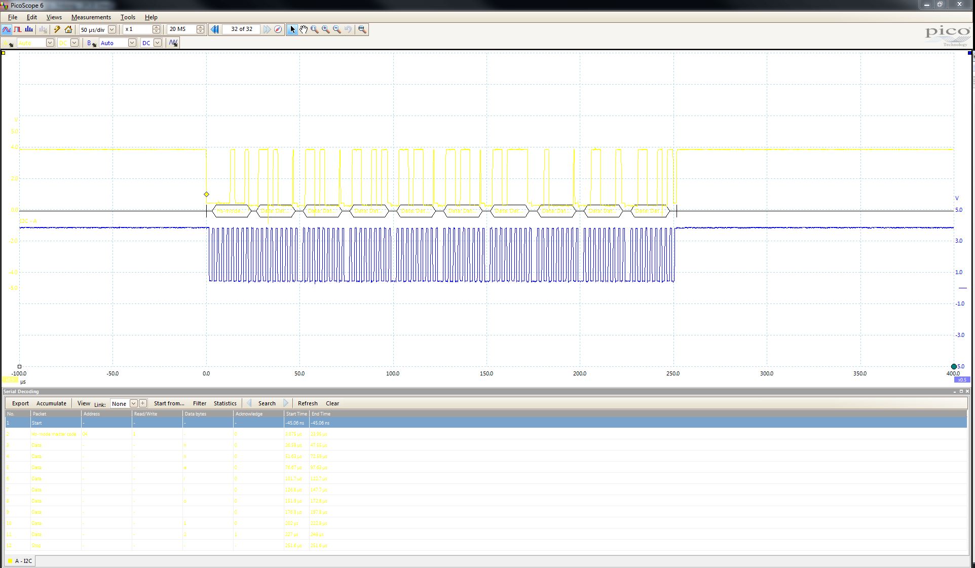

I am having trouble receiving constanent data from my slave sender. I am sending "hello 123" and sometimes the master receives all of that string and then other times it only receives the first letter in the string, "h". I attached my code and some screen shots below. What am I doing wrong?

  • Hello Andrew,
    Please note that the Master is Receiving. The Slave is transmitting. So is the Slave program working as expected? I have updated the original thread as well.
    MSP430 device may have some subtlety that would require the MSP430 Program code to be modified.
