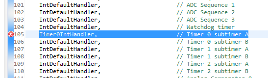

I get an error due to, seemingly, following directions in Lab 4 of the TM4C123G LaunchPad Workshop. To enable a timer0 interrupt I pasted such into tm4c123gh6pm_startup_ccs.c as directed:
My compile error is
--preproc_dependency="tm4c123gh6pm_startup_ccs.pp"  "../tm4c123gh6pm_startup_ccs.c"
"../tm4c123gh6pm_startup_ccs.c", line 105: error #20: identifier "Timer0IntHandler" is undefined
1 error detected in the compilation of "../tm4c123gh6pm_startup_ccs.c".
which indicates that a header file is missing. Here are the header files in main.c:

while the header files in tm4c123gh6pm_startup_ccs.c is only this:
#include <stdint.h>
I have searched through .h files, but have not been able to find Timer0IntHandler, which is maybe the problem. Please advise.
    At the beginning of startup_ccs.c file, after all #include declarations you must add this one:
    extern void Timer0IntHandler(void);
    and in your source file you must define also the function, extern, to be found by the linker.
