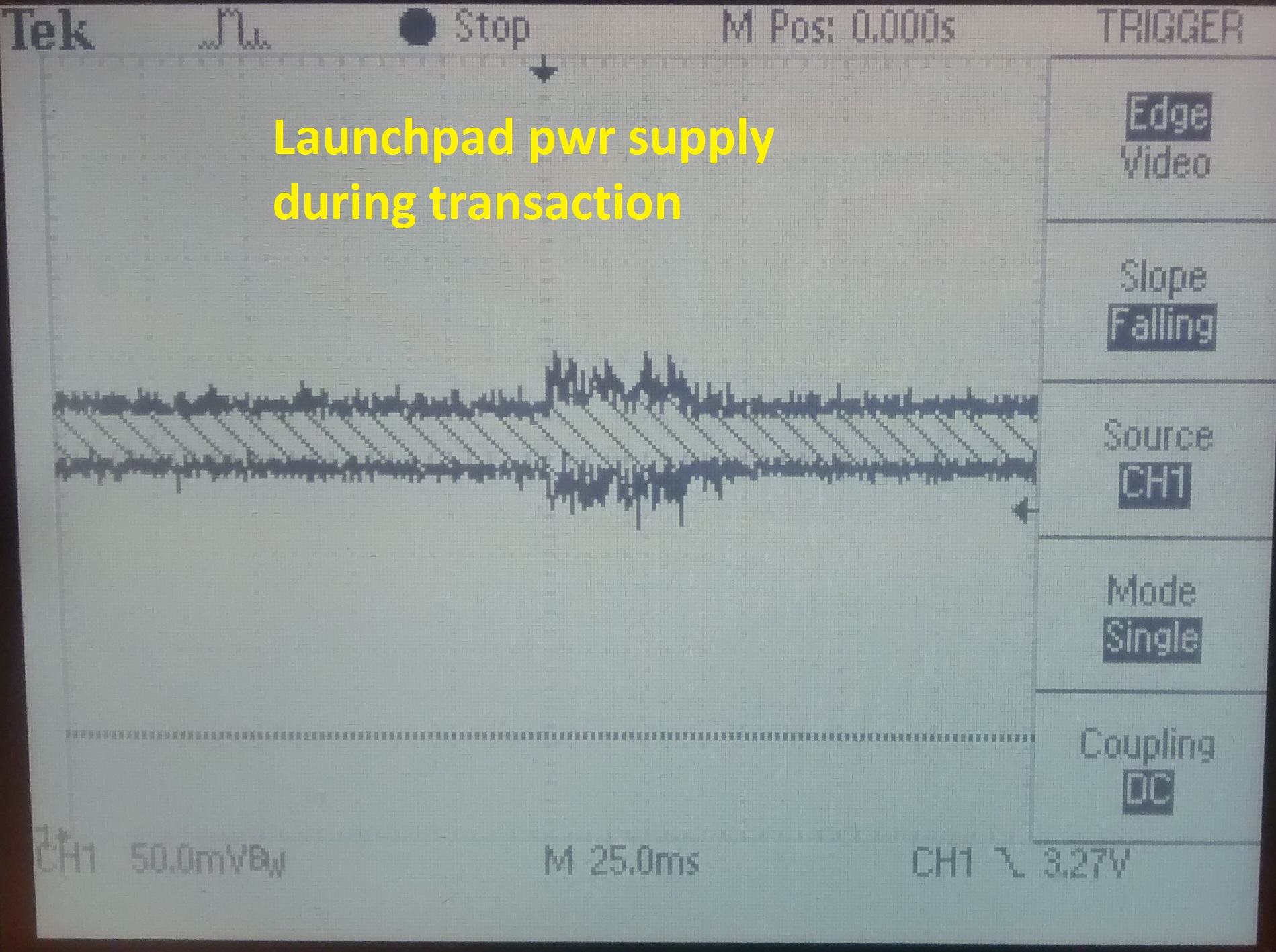

  • I didn't see any spikes when I had the scope set to <250ns/div.
    When measuring the +3.3V on the Launchpad (used for sensor power), though, I did observe the attached picture...  The big noise occurs during SD card writing.  The SD card is on a separate power supply, which also shows the same sudden noise however.
    That's a good sign.
    OK, now you have a good candidate. Definitely also check your micro's analog supply and reference.  However, even the sensor getting that noise level could be an issue.
    If you have a way to do so you could run an isolated power supply to the SD card (A battery and an LDO?) so you can minimize the disturbance on your main supply. From the looks of things you need a good set of bulk capacitors on that supply.
    I'm assuming the SD card and your main 3V3 share a common source supply.
    Robert

  • Further scope shots. SD card on separate power supply:
    Launchpad power supply:
    I still need to put the sensor back in and observe the hopefully reduced noise on the ADC measurements, but I need to leave this for the moment. This is looking promising, though.
