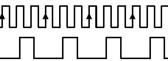

    These images may illustrate what i´m trying to do;
    -----------------------------------These are the clocks i synced.
    -----------------------------------This is how i need the bottom clock to be.
    They both end at the same time.
    By explaining this i noticed that inverting wont solve my problem either because both clocks may end at the same time but opposite to each other.
    Can you give me any suggestion about how to accomplish what i want?
    I´ve seen some threads about dead band or comparators but i´m unsure about how to use that approach.
    Best regards.

  • Hello Andy,
    I think the solution using the Timer for PWM would be to invert both the signals after setting the time base identical and the match value as per the low time of the PWM signals.

  • Hello Andy
    You would need to set the register-bit GPTMCTL.TxPWML to invert the PWM output.

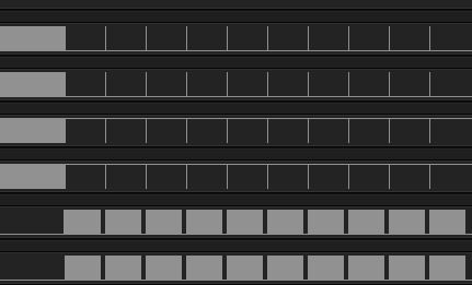

    Here is a screenshot of the last ms of the operation;
      (attempts to write to the inversion register)

  • Hello, Amit!
    How are you?
    You probably did not see my last post, but i´ve been occupied with some other stuff and now I was working with the LMF4 again.
    I´ve found how to invert the clocks trough this site http://www.multiwii.com/forum/viewtopic.php?f=22&t=2376&start=30
    The instruction is this one : HWREG(TIMERx_BASE + TIMER_O_CTL) |= TIMER_CTL_TAPWML;
    The nice thing about it is that the wave form i need is achievable through the TIMER_PWM_MODE output inversion.
    It seems that by inverting the output of a synced timer, the correspondent registers that control the match in countdown also gets inverted.

    I said that by inverting 2 synced timers i got what i wanted, but i was wrong.
    These are 3 images for;
    • What I need
    • What i got by inverting 2 timers synced
    • What i got by syncing 3 timers and inverting one of them (85% dcycle for the 3rd timer)
    So, you see (bottom pic) , by combining the second timer (which is inverted with the first) with the third timer I get the signal from the first picture.
    By the way, i started the SPI tests and it went really good. It was easy to configure following the example in stellarisWare and the data logger helped by reading the protocol and showing the data directly on the graph.
    Andy.

  • Hello, Amit!
    Yes, I notice that.
    ..."Your forum post was approved and has been posted."...
    For some reason my reply went to the red tape and only after that it was available. I don´t know why the pictures were removed.
    Any how, what you said some time ago about the inverting both timers and then adjusting the dutyCycle was correct.
    If I invert 2 timers I get the wave i was looking for.
    I have my complicometer switched on too often.
    My problem, now, is with some clocks that need to send to the ADC for video sampling.
    I need a master clock to be around 4Mhz+ and there must be an exact number of pulses of this MCLK in between the pulses of another timer VSMP.
    A waveform like the one in the picture; (sorry if it doesn´t show up)

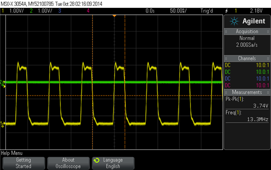

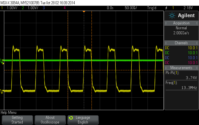

    I did a simple code for GPIO toggle using the following
        SysCtlClockSet(SYSCTL_SYSDIV_2_5 | SYSCTL_USE_PLL | SYSCTL_OSC_MAIN | SYSCTL_XTAL_16MHZ);
        SysCtlPeripheralEnable(SYSCTL_PERIPH_GPIOF);
        SysCtlDelay(10);
        GPIOPinTypeGPIOOutput(GPIO_PORTF_BASE, GPIO_PIN_1);
        GPIOPinWrite(GPIO_PORTF_BASE, GPIO_PIN_1, 0x00);
        while(1)
            HWREG(GPIO_PORTF_BASE+0x3FC) = 0x2;
            HWREG(GPIO_PORTF_BASE+0x3FC) = 0x0;
    and it gives me 13.3MHz.
    I would try to do a uDMA example but I think first let us confirm on the data on your setup and mine.

  • Hello, Amit!
    Thanks very much for your tests and conclusions.
    Indeed using HWREG macro is quite faster then assigning a value to GPIO_PORTF_DATA_R.
    I would thought otherwise.
    The oscilloscope I have here shows 16MHz and the logic analyzer show 8Mhz., but non of these instruments are anywhere comparable with an Agilent. The sum of the price of the oscilloscope and logger would probably not be enough to buy an Agilent probe. So, i´m sure that your measurement is the most accurate.
