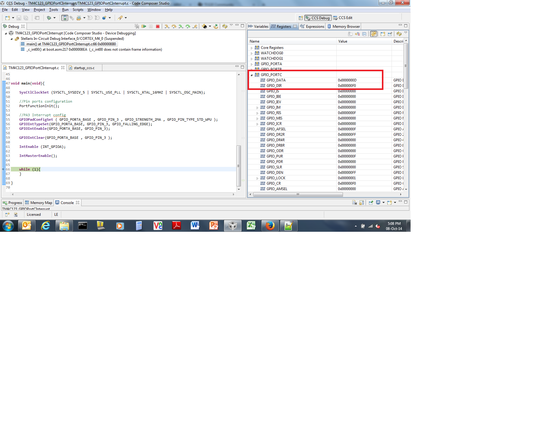

  • Hello Jose
    I ran the code you had and the Port C Pins changed the value from 0 to 1, when PA3 is connected to GND (falling edge)
    Before PA3 falling edge
    After PA3 Falling Edge
    Amit
