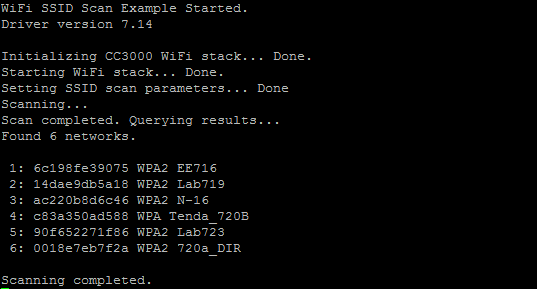

so,i try  \TivaWare_C_Series-2.1.0.12573\examples\boards\ek-tm4c1294xl-boost-cc3000\cc3000_ssid_scan.
example result (one time):

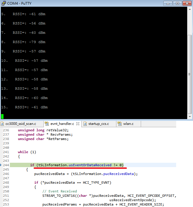

then, add (sScanResult.ui8ValidRSSI) for RSSI and add some loop for 100 times
if((sScanResult.pcBSSID[5])==0x2a)       // object WiFi SSID 0018e7eb7f2a
UARTprintf("%d.",real_times);                  // int real_times for count
UARTprintf(" RSSI=: %d dBm\n",(((sScanResult.ui8ValidRSSI)>>1)-128));    //output RSSIvalue
real_times++;
but my program always Hang at tSLInformation.usEventOrDataReceived (loop about 15 times)
like this
some people said patch the Host Driver to 1.12
I don't know what my Host Driver version is  (In first picture display driver version 7.14 )
and how to patch.
tried to run another example cc3000_patch_programmer for patch
but when the 100 times program run,it Hangs at tSLInformation.usEventOrDataReceived equally.
Is it right to Download  CC3000 Host Driver Downloads v1.12 SDK ?
Can Patch solve my problem?
