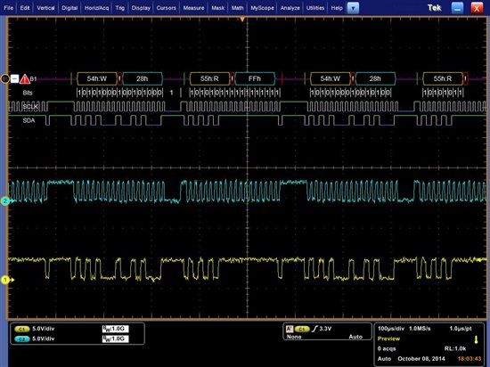

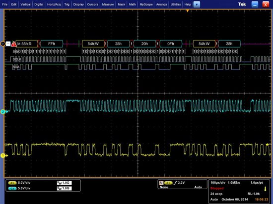

My problem is the transfer the slave address, because I can see the signal of SDA and SCL in the oscilloscope, and I see that this is wrong. Send the image of the signal transfer and write my code.
The slave addres in the signal is 0x54h while the slave addres in code is 0xD4h. I think that the bit MSB in the slave address is lost, i don't know why.

Signal of the : " L3gd20_Init();"
Signal of the " gX[0]=ByteReadL3GD20(0x28); "

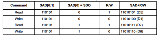

  • I send the patterns of transmision that the datasheet propouse
    Write function
    Read Function
    The value of SAD+W and SAD+R is determined by this table. I use 0xD4h and 0xD5h
  • Hello Sanchezbjc,
    The Slave Address that is written to the master is left shifted by the API to accommodate the R/W bit. So the actual SA shoyld be SAD[6:0] and not SAD+R/W
    In other words use the value 0x6A for Write and Read.
    Amit

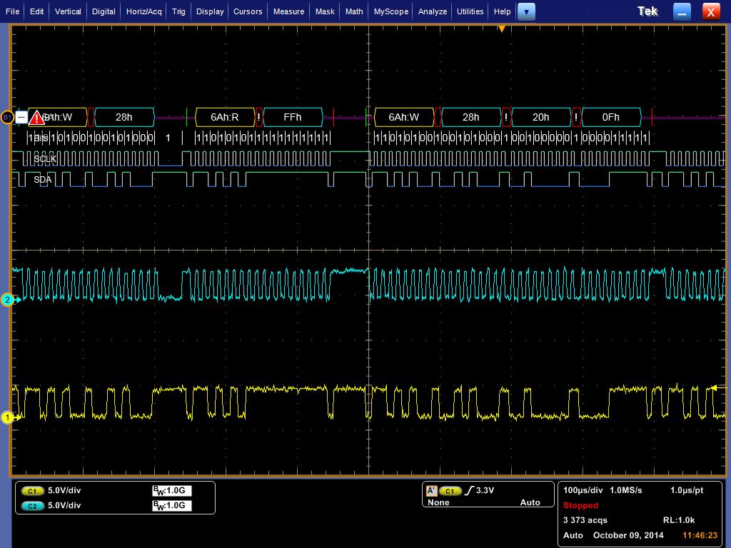

  • Thanks Amit, I change the value and the signal in oscillospe is correct, I can not read well the sensor 0xFFh Because the data is, but I will continue working
    I see a error in the initialization of sensor, I will correct
  • Hello Sanchez,
    The TM4C I2C Master uses the 7:1 of the Slave Address for some devices in which the manufaturer adds the RW bit also to the Slave Address.
    So in summary, when the Device address is specified as a 8-bit value consisting of Slave Address+R/W then right shift the value and use the same in hex notation for TM4C I2C.
    Amit

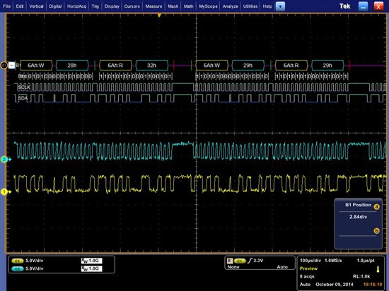

    I send the image with the signal of the correct transmission
    Axis X
  • Hello Sanchez,
    What was the final issue and it's resolution? Our forum would appreciate such info for future users.
    Amit
  • Hello Amit,
    Well, the solution was to use the value of 0x6Ah as slave address for writing and reading.
