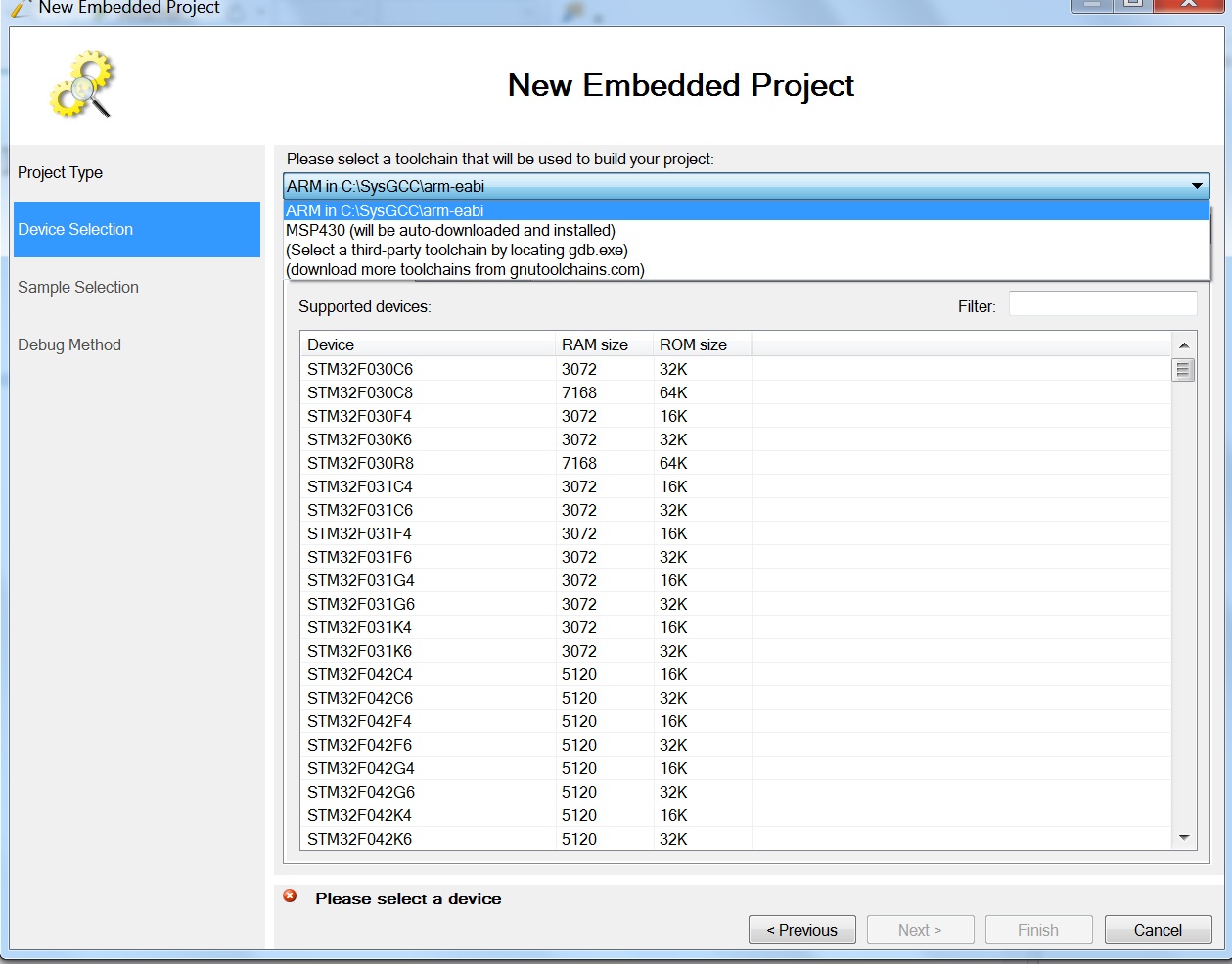

  • Here is a screen capture:
    I don't have the "non-eabi" toolchain and I don't know what my device is..
    No, not this one - what I meant was to click on "Specify the flags manually" and post that a picture of that new tab - it is clear your device it is not on the list, can be seen from the beginning, that's why I suggested the Eclipse+...
    Are we sure?  Poster's snip only reveals STM32 MCUs (why is that?  seems ill-focused) - thus LM3S29xx may still appear - somewhere.  Should such (proper) search succeed - would that not save great time/effort & greatly reduce "back-forth" for, "helper?"  (i.e. Petrei)

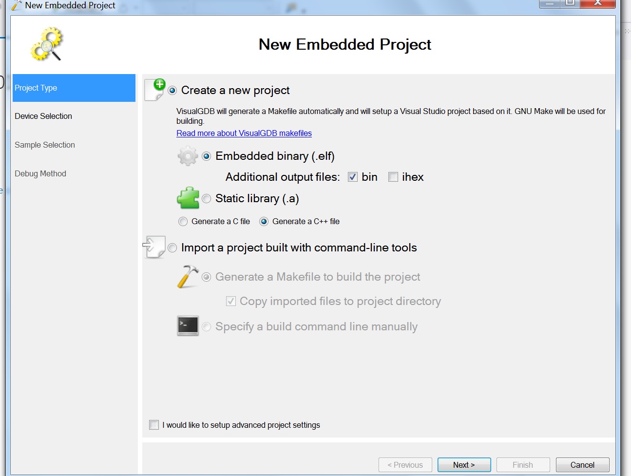

  • I don't really understand. When I create a new project, the first screen is:
     and
    and the second one was posted earlier.
    What should I do exactly?

    Well, all micro familes suported are specified on manufacturer web site, and neither Tiva nor Stellaris appear (while MSP430 is present) and the "legacy" special info is present, so if the o/p processors is not on the list, could be treated as "legacy", meaning the user can write/pass the compiler switches (as explained in that page). So that was my thinking.
    The weird thing is the compilers packages specified are all arm-eabi- which defy the usual convention that bare-metal arm micros are all arm-none-eabi- and however the STM32F4xx are presents on the list - maybe is something special and of coarse this should be asked at the manufacturer, not here.
    @Romain, I was speaking about the step#4 in the indications page; see the message "Specify the flags manually" - click on that to set all compiler switches as specified in the legacy page - my intention was to force you to find it out and to use it.
    I've found this manual option but the next screen asked me for the flags and I don't know what to write there. What you call the "legacy page" is something I can't find. What is it exactly?

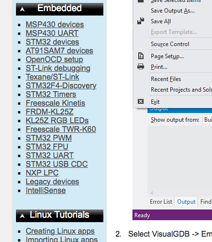

    a) Legacy page is to be found on easily - look on this picture:
    It is named "Legacy devices".
