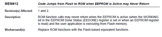

    Yes, this is the exact issue with TM4C129 rev-2 devices. The rev-3 devices have this fixed. So in the meantime the ROM_ADC API call must be replaced by ADC API call from Flash

    I have to say, the previous wording of this errata (and your question above) made it sound like the ROM_EEPROM* functions were the only functions affected. The new wording of the errata seems to indicate that any ROM functions will cause this issue.
    Can you confirm this? Any usage of ROM functions whatsoever, even for things unrelated to EEPROM, will cause the problem to occur?
    Ben
  • Hello Ben,
    I think the wording is very clear on the Latest Errata
    Amit

    I am now running into a similar problem as Ben. I am using both the USB driver library and the EEPROM. Sometimes my program never returns from EEPROMProgram and the USB stops functioning. My guess is that the problem is related to this errata (USB interrupt occurs during Program). I am using MAP_ calls throughout my program, so I undefined TARGET_IS_TM4C129_RA1 thinking that this would force the program to use the Flash based functions. But this didn't solve the problem. I notice that all through the USB driver, the MAP_ calls are also used. Do I need to recompile the USB driver so it doesn't use ROM?

    Yes, please recompile the USB and the main driverlib files.
    Amit
  • Amit,
    I think I have successfully recompiled usblib and driverlib. I also removed the #define TARGET_IS_TM4C129_RA1 from my project and removed all #include "rom.h", so I think that my project is running all code from Flash. When I debug and look at disassembly it looks like this true.

    1. Calling ROM functions while EEPROM was active. I solved this by removing ROM functions from my program and recompiling the USB library to not use ROM functions.
