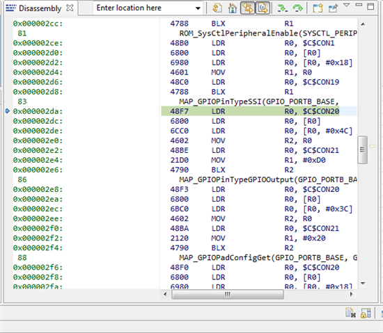

I'm exploring a TM4C123GLX Launchpad, using CCS v6 with the TivaWare C driver library.
I'm baffled at the seemingly liberal amount of instruction reordering that the C compiler is doing in the generated assembly, even at the Debug level. My setup is as follows:
  • I have added the Examples directory of TivaWare to the TI Resource Explorer
  • I cloned an example project from the Examples/Boards/ek-tm4c123gxl directory
  • I'm using the default "Debug" build configuration
  • I'm using the function-style of the peripheral driver library of TivaWare
  • An example of the code is as follows:
uint32_t pad, strength;
MAP_GPIOPinTypeSSI(GPIO_PORTB_BASE,
                   GPIO_PIN_4 | GPIO_PIN_6 | GPIO_PIN_7);

However, in the debugger view the annotated generated assembly is:
194           MAP_GPIOPinTypeSSI(GPIO_PORTB_BASE,
000006ca:   6A20     LDR             R0, [R4, #32]
203           MAP_GPIOPadConfigSet(GPIO_PORTB_BASE, GPIO_PIN_7,
000006cc:   4D21     LDR             R5, $C$CON12
000006ce:   6CC0     LDR             R0, [R0, #76]
000006d6:   4790     BLX             R2
197           MAP_GPIOPinTypeGPIOOutput(GPIO_PORTB_BASE, GPIO_PIN_5);
000006d8:   6A20     LDR             R0, [R4, #32]
000006e2:   4790     BLX             R2
198           spi_cs_clear();
000006e4:   6A20     LDR             R0, [R4, #32]
000006f0:   4798     BLX             R3
201           MAP_GPIOPadConfigGet(GPIO_PORTB_BASE, GPIO_PIN_7,
000006f2:   6A20     LDR             R0, [R4, #32]
00000700:   47B0     BLX             R6
00000702:   6A20     LDR             R0, [R4, #32]
00000710:   47B0     BLX             R6
Do you notice how MAP_GPIOPadConfigGet is absurdly executed after MAP_GPIOPadConfigSet, when it is clearly otherwise in the code? And this is not the only instance of this situation. So, is there some preprocesor directive or something that wll force the compiler to generate the assembly following the exact same order I wrote in my C source?
    Based upon the posted fragment, which skips some assembly instructions, I can't tell if the actual call to the functions has been re-ordered, or if the compiler optimizer has just re-ordered some instructions prior to the actual function calls (BLX instructions).
    Under CCS Project Properties -> Build -> ARM Compiler -> Optimization set the "Optimization Level (--opt_level, -O)" to "off".
  • Hi Chester,
    Indeed I skipped the instructions in between a block (only and precisely were I put ellipsis "...", ), but I did include the BLX instructions corresponding to the C function call.
    If you check my original disasembly listing, it seems that the functions were actually executed in the proper, expected order, but the compiler simply issued "pre-emptive" LDR instructions somehow related to the functions. In the disassembly listing you find two examples:
    • the MAP_GPIOPinTypeSSI function in lines 1,2 and 5-7.
    • the MAP_GPIOPadConfigSet function in lines 3,4 and 21-24
    So this was confusing me while I was stepping over the lines. Apparently there is no issue, just an unexpected, weird, but harmless side effect.
    Thanks for the tip. I have considered doing that but if the library is to be useful for production work, disabling optimizations would be off-limits. It is good to keep in mind though.

  • Hello Luis,
    I took the code into one of my programs and it generated a different dissassembly, one that seems correct in terms of LDR and BLX
    Amit
