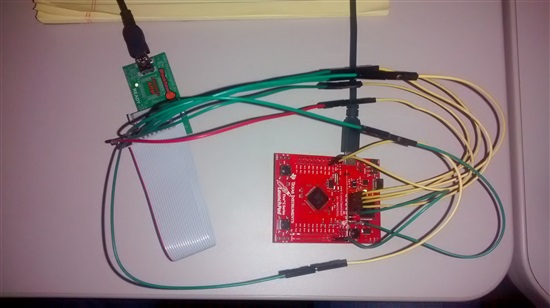

Using CCSv6, Win8.1, TivaC 123 Launchpad, Blackhawk XDS100v2,
I am trying to Debug-In* to the U1 TM4C123G which is on the Launchpad, with my XDS100v2 so that I can program the mcu without the ICDI. However, my attempts at doing so through CCS are being met with the following error:
Error connecting to the target:
(Error -1170 @ 0x0)
Unable to access the DAP. Reset the device, and retry the operation. If error persists, confirm configuration, power-cycle the board, and/or try more reliable JTAG settings (e.g. lower TCLK).
.* http://processors.wiki.ti.com/index.php/Stellaris_LM4F120_LaunchPad_Debug_How_To
My ccxml file is basic:

If I use the "Test Connection" feature, then I get the following output:

My TCK, TMS, TDO, TDI, Reset, GND pins are connected. Ext DBG is connected to GND. The VTref of the XDS is connected to the Launchpad +3.3V header pin. The Launchpad power select switch is set to "Device" and a USB cable is plugged into the device USB port. The one jumper which is usually on the board to connect power between the two mounted mcu's is removed.
Power cycling the assembly does not change the error messages.

Hello Snellr
How is the XDS100v2 connected to the TM4C123 launchPad. If you can give XDS100v2 header to TM4C123 Pin Mapping it would be useful information
Amit
Using ARM 20-Pin 0.10" 2 row Molex, here are the pin connections from XDS100v2 to TivaC123G Launchpad headers. Additionally, the USB cable is plugged into the USB device port and the power select switch is set to device. No jumper is employed.
XDS | Tiva |
1 (VTRef) | Pin 1.1 (+3.3V) |
5 (TDI) | TDI |
7 (TMS) | TMS |
9 (TCK) | TCK |
13 (TDO) |
TDO |
15 (nRESET) |
(RESET) |
4 (GND) |
GND |
And I have attached a couple images for reference.
Thanks.
After one change, the assembly is working. I had to insert the VDD jumper ("to connect the 3.3V pin and the MCU_PWR pin" ~SPMU296 ).
