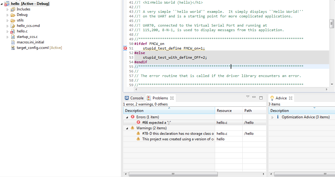

The other day I updated my annual subscription to CCSv6 and I am having problem with the preprocessor descriptions for one project.
I am using some ifdef commends but CCS is not aware of the changes, and the compiled file is generating the same version no matter the define name I use. However the editor is updating (with gray areas properly).
As an example of that, this screen capture. The compiler is hatling at the not defined area!!!
How can I solve this problem?
Thank you.

  • Consider your assumption might be wrong.
    The grayed-out editor view in this #if / #else / #endif is not the result of the compiler, but a parser which eclipse calls/uses, so you might get fooled. Using another Eclips-based toolchain at my dayjob, I see that kind compiler/parser disagreement ever day.
    When in doubt what the compiler actually sees, add a line like #warning "variable xxx defined, branch yyy taken" to your code, and check the compiler output.
