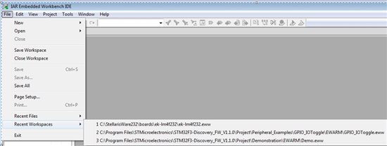

  • As an illustration - here's the vital, initial IAR start-up screen:
    Note that IAR truly "seeks" the .eww files - as those represent the entire "workspace" and go far to insure proper operation.  You may note that another's ARM files also include .eww - and (again) we added nothing to create such necessary .eww files - they arrived exactly (premade) as listed...
    Projects appear of much less importance - in fact under "New" & "Open" the only choices are, "File" and "Workspace."  While you may have succeeded w/"projects -> add" we believe "workspace" to be the safer - and more obvious - first action...

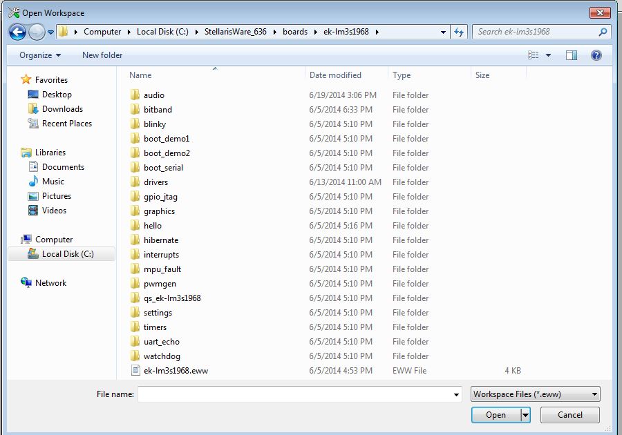

  • Here's one more screen-shot under IAR - this time showing the result after clicking, "Open":
    Note that IAR really does seek the .eww file (we did nothing to modify this screen) - and that even our past LM3S1968 contains such a .eww file!
    We did not "add to a project" nor do anything to "create" this .eww file - just as w/other ARM vendors SW - it was included as a pre-made file.
    Perhaps TivaWare has "moved" from this .eww file scheme - yet each of our 3 other ARM MCU vendors all employ the .eww - seems to make sense to, "stay w/the herd."  (thus our comfort w/StellarisWare - it's robustness/safety!)
