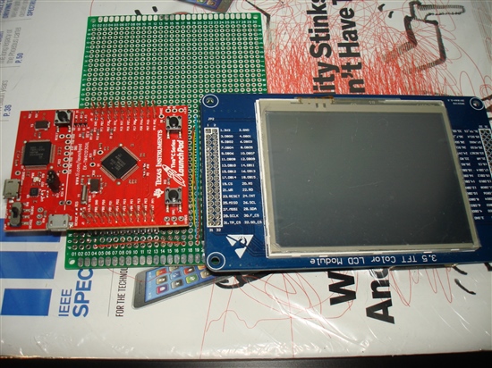

 Hi All, reflection about interfacing a TIVA LP 123 series with a TFT panel:
 Just one example exists and is dedicated to Kentec 3.5 Boosterpack and just on Ek-TM4c1294XL, this code is not so simple and also scare me due to how it is written...
 On Kentec display site code remain locked to old Stellaris series and cannot be used on tiva due to new code and library format.
 So when I recently answered "code is on example" I got a great mistake.. It was on example!!
 Please accept my apologizes for, but this is to ask TI to repopulate examples and comment better to explain how these can be customized.
 Again graphic library appear hard to use due to hardwiring of some part of TFT driver, on original Stellaris I have spent a lot of time separating hardware dependent part making a HAL part able to use all code from a device descriptor and simply add HLL with pin assignement and a device descritor table with all capability of TFT interface.

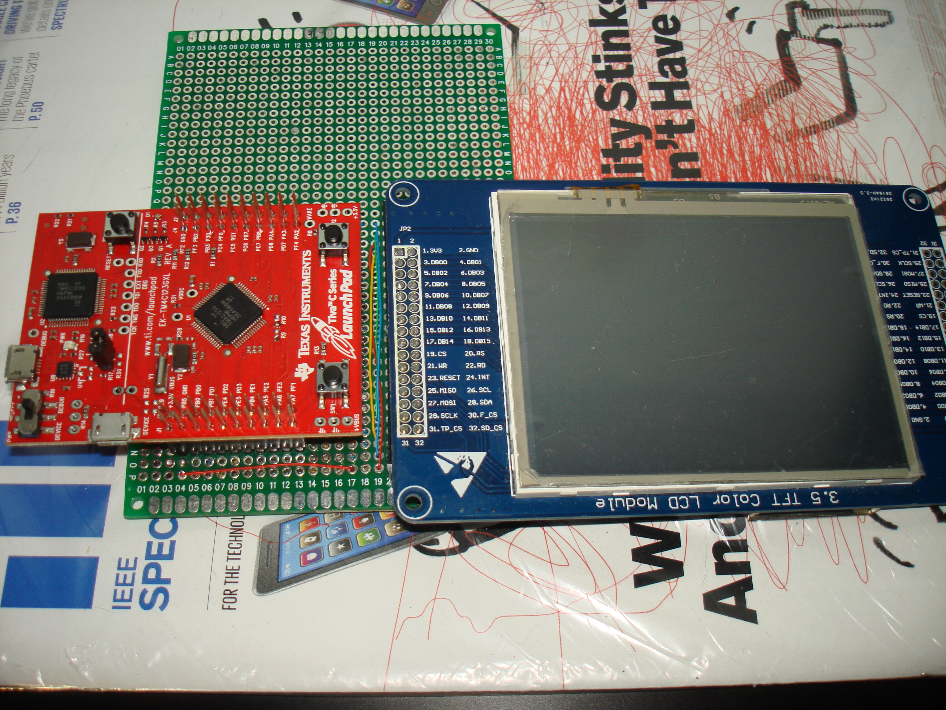

 From kentec get datasheet then see where is D7 on BP connector, J2_6 PB7, D6 on J2_7 PB6, D5 on J1_2 PB5 and so on, but what is connected on EK-LM4C1294XL BP connector???
 Numbering is different from schematic of Kentec and TI so transcoding show it can be on Boosterpack 2,
 J1 Kentec map to TI X6 odd number J3 Kentec map to TI X6 Even number
 J2 Kentec map to TI X7 Even number J4 Kentec map to TI X7 Odd number
 A real disaster for a poor beginner on this so dangerous way....
 J2_6,7 map to  X7 12,14 PQ2, PQ3
 J1_2 map to X6 3 PD2 all the other follow the port bit from new connector assignement.

 Ok this hacking problem got solved but why not spend some word in front of this say:
 Connect Boosterpack on Socket 2,
 pin are assignement is different from original 120 stellaris launchpad so we adapted in this fast way...
 And if driver is changed a lot why not provide too a driver to use LCD BP also on 123GXL launchpad??
 Data pin are on GPIO B D0 B0 ... D7 on B7
 Who read this from TI please clean up all TIVAWARE library, please provide universal LCD driver usable on all example with a customization of HAL level only...
 Do move on base tiwaware driver as is for Grlib too. We wish also driver for solomon and  ILI simply to customize on serial or parallel interface, it is not so difficult to do.

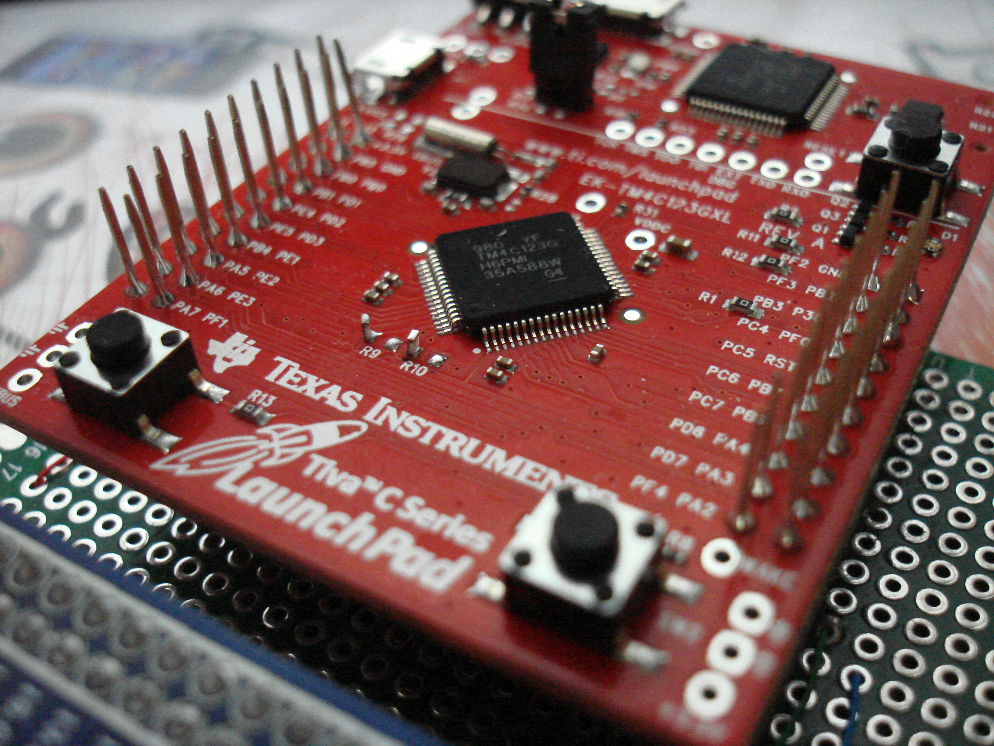

     Oh.. thank a lot but see what can I do with an old multiple use unspecialised simple weller soldering iron:
     On every board I do same job to remember me and who use that to do this IMPORTANT JOB, it costed me an LX120 launchpad and one day pain!!
    so on not so close view.. did you remember this? It was ok with lx120, not with tm4c123, so as a gift if possible I prefer an  universal TFT driver like the one I tailored for old stellaris LP....
     CB1..... Stand UP a minute like R9 and R10 please ;)
  • Roberto - with R9 & R10 "tomb-stoned" my small group stands silently - each dressed in black - to pay our respects.  (especially to your departed LX4F120 board)
