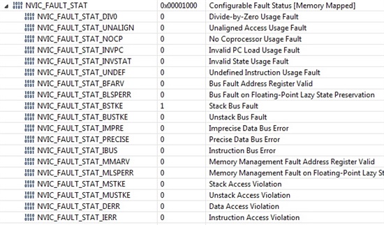

    Let me explain you my code. I am running a Brushless DC motor. I am sensing three position sensors and according to that I am generating firing signal for inverter. I am using Interrupt at port B and pwm at port F. both of them (pwm and interrupt) are not working simultaneously. If I use only one, everything works fine. Kindly have a look at code. Thank you.
    Prashant

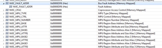

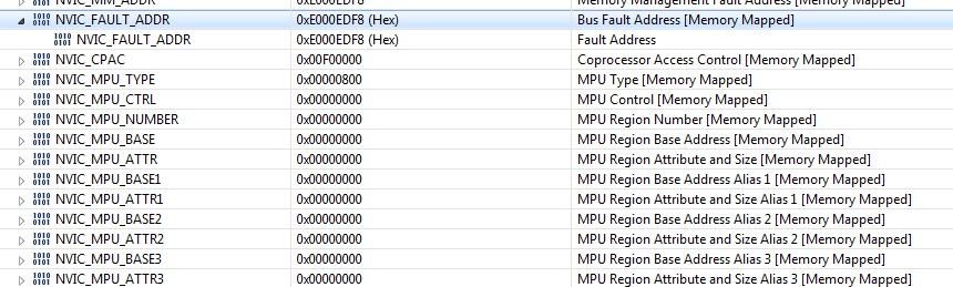

  • Hii amit
    I am posting NVIC registers content after fault. Kindly look at above comment for detailed problem.
    Prashant
  • Hello Prashant,
    There is a Stack Bus Fault which would point to the Floating Point Unit not being enabled whose fault has causes an issue on the SP
    Amit
