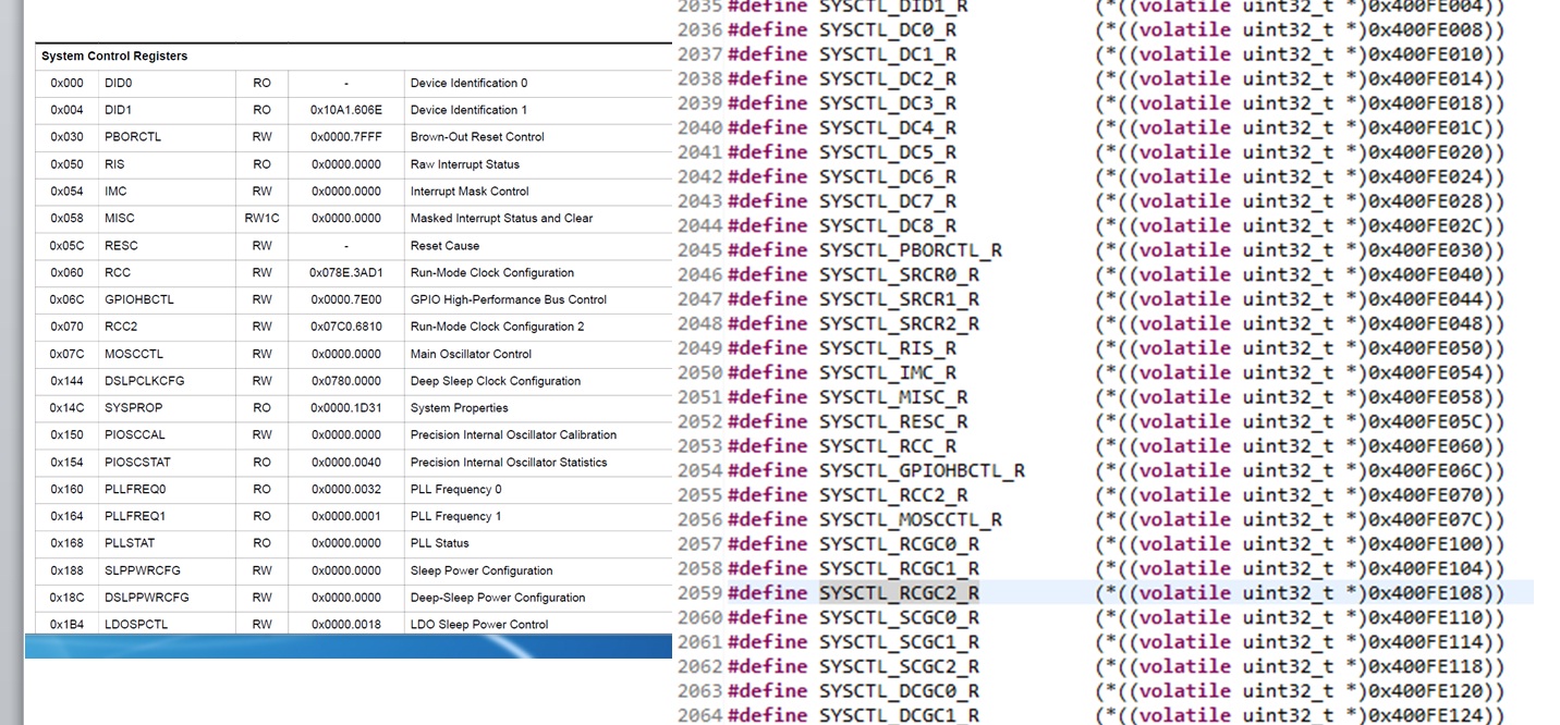

    Here is an example:
    This SYSCTL_RCGC2_R is at address 0x400FE108 according to the "tm4cgh6pm.h" and has something to do with System Control registers. The problem is that I can't find such address in the datasheet in order to understand its purpose.
    There are other macros for registers with addresses that doesn't exist in the datasheet.

  • Hello Radoslav,
    The RCGC2 register is a legacy register in System Control Module and would be in a second table just after the one you pasted. Simply: Search for 0x108 in the System Control Module section of the data sheet.
    Coming to the original code, you enabled the RCGCGPIO (which is the preferred mehcanism) bit for Port-F. However it takes time for the clock to be enabled and you should have put a delay loop before accessing the GPIO Port-F register.

    Amit you pointed out that my miss is the delay loop that gives some time to the processor to enable the PORTF clock. OK in my code the address of the PORTF data register is 0x40025000, but the macro for that register in the tm4c123gh6pm.h is different 0x400253FC. I am not very good in finding registers in the datasheet, thats why I ask you for help.

  • Hello Radoslav,
    The header file only gives the full address for each register in each peripheral instance. To get to the correct register in the data sheet, you must go to the section for it. For example in this case GPIO Section. In the table the register offset (last 12-bits of the address) is given. The base address 32-bit is given just before the table and before every register description. An addition of the same will give you the full 32-bit addtess for the register in a particular peripheral instance,
    Just to be clear: A peripheral can have multiple instances... For example GPIO has Port A, B, C.... and so on. So even though the peripheral is 1, the instances are N.
