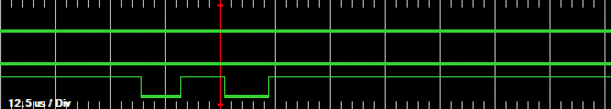

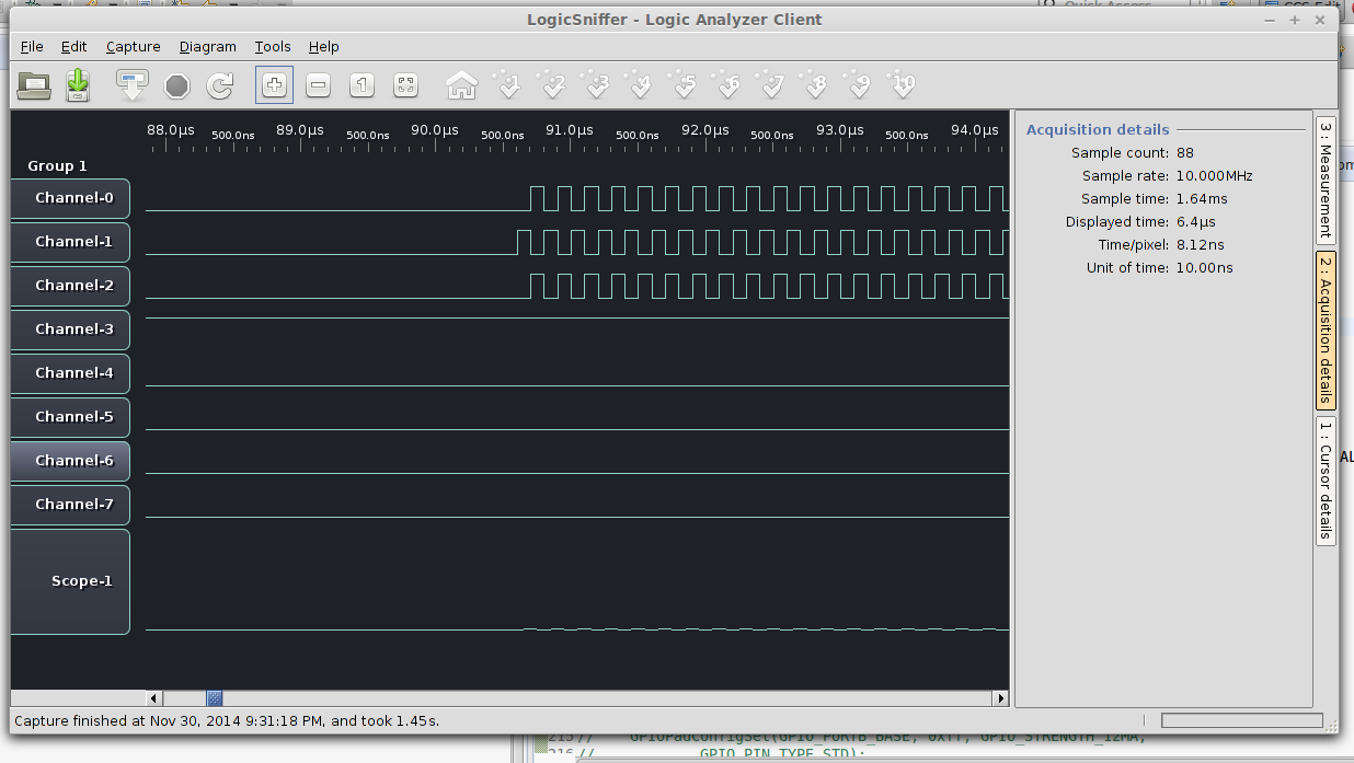

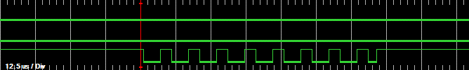

I have been trying for several hours to get a simple I2C circuit setup with the TM4C123GXL board and an MCP23017 IO Expander. I've looked at many forum posts about I2C problems with this board, but none have helped. Currently I'm using code from http://e2e.ti.com/support/microcontrollers/tiva_arm/f/908/t/235977.aspx for the I2C setup and address scanning (it loops through addresses from 0 to 127 and tests if they acknowledge):

return 1;
For some reason, the program reports that there is a device at every address from 0 to 127 (ie ROM_I2CMasterErr always returns 0), even though I only have one. I have 4k7 pull-up resistors on SCL and SDA and several 0.1uF bypass caps. The reset pin is also connected to 5V (active-low). Any ideas what could be wrong?
