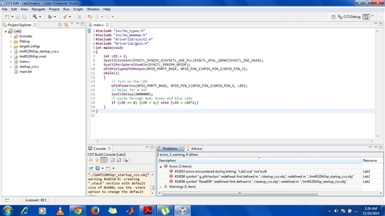

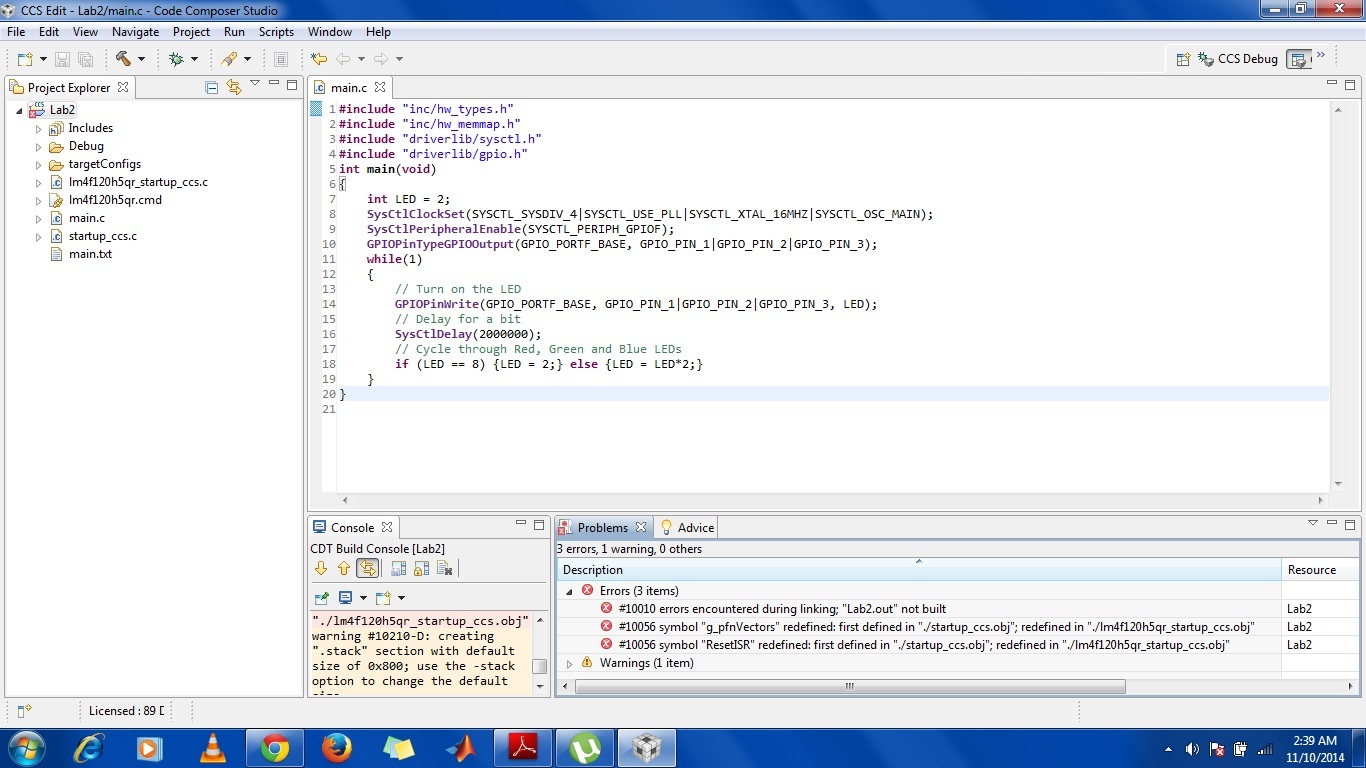

I'm using a Stellaris Launchpad,but I'm facing problems while debugging.I followed exactly the same steps as mentioned in the workbook.Please check the errors below and guide me through the exact steps for successful debugging and compiling....
Hello Amit,
Any CCS version, more than one startup or linker cmd file is not permitted.
