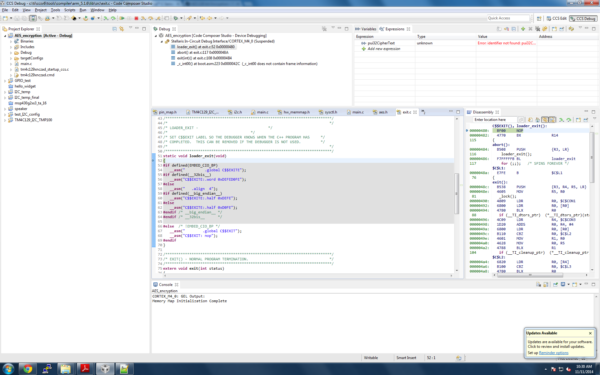

I'm trying to run the code for AES encryption given in the peripheral driver library. Earlier I have implemented AES encryption in Virtex-5 FPGA. In the code I noticed following things.
- SYSCTL_PERIPH_EC0 is not defined. I tried looking for other peripheral and i found that I have to use SYSCTL_PERIPH_CCM0.  CCM is actually an algorithm which uses AES encyption. So why there is not something defined like SYSCTL_PERIPH_AES?
- Also AES_BASE is defined. So how can I check whats the related peripheral to that AES_BASE?
- Also in the APIs there is no option for clock. So how does the peripheral gets the clock? I checked the datasheet also and there is nothing mentioned about the clock?
- Also When I debug the code it gets stuck in exit.c . Check the attached image to see where does it actually gets stuck. I dont know how to get out of there. Please help me
  • Hello Spandan89
    1. SYSCTL_PERIPH_CCM0 is the correct macro for SysCtlPeripheralEnable to enable the clock to AES
    2, The AES_BASE is a part of the CCM Address Space along with other crypto modules
    3. The code needs to be published for us to see why it goes to exit.c

  • Hi Amit,
    I think i may be omitting some of the include file, but i'm not sure. here is the coed.

  • Hello Spandan89,
    It seems that the exit is being called after the program completes. Put a while(1) loop at the end to prevent it from going to exit handler.

  • Hi Amit,
    I made a silly mistake. But i still dont understand the clock part? how is the peripheral getting the clock? AES involves polynomial mathematical operation which many xor operation between bytes of data. The only possible way is that, the controller is by default giving the clock to its peripheral. But then again, whats the clock value? 120MHz???

  • Hello Spandan89
    The SYSCTL_PERIPH_CCM0 Macro is the one which enables the common system clock to all of the crypto modules. So there is no AES specific bit as such.
