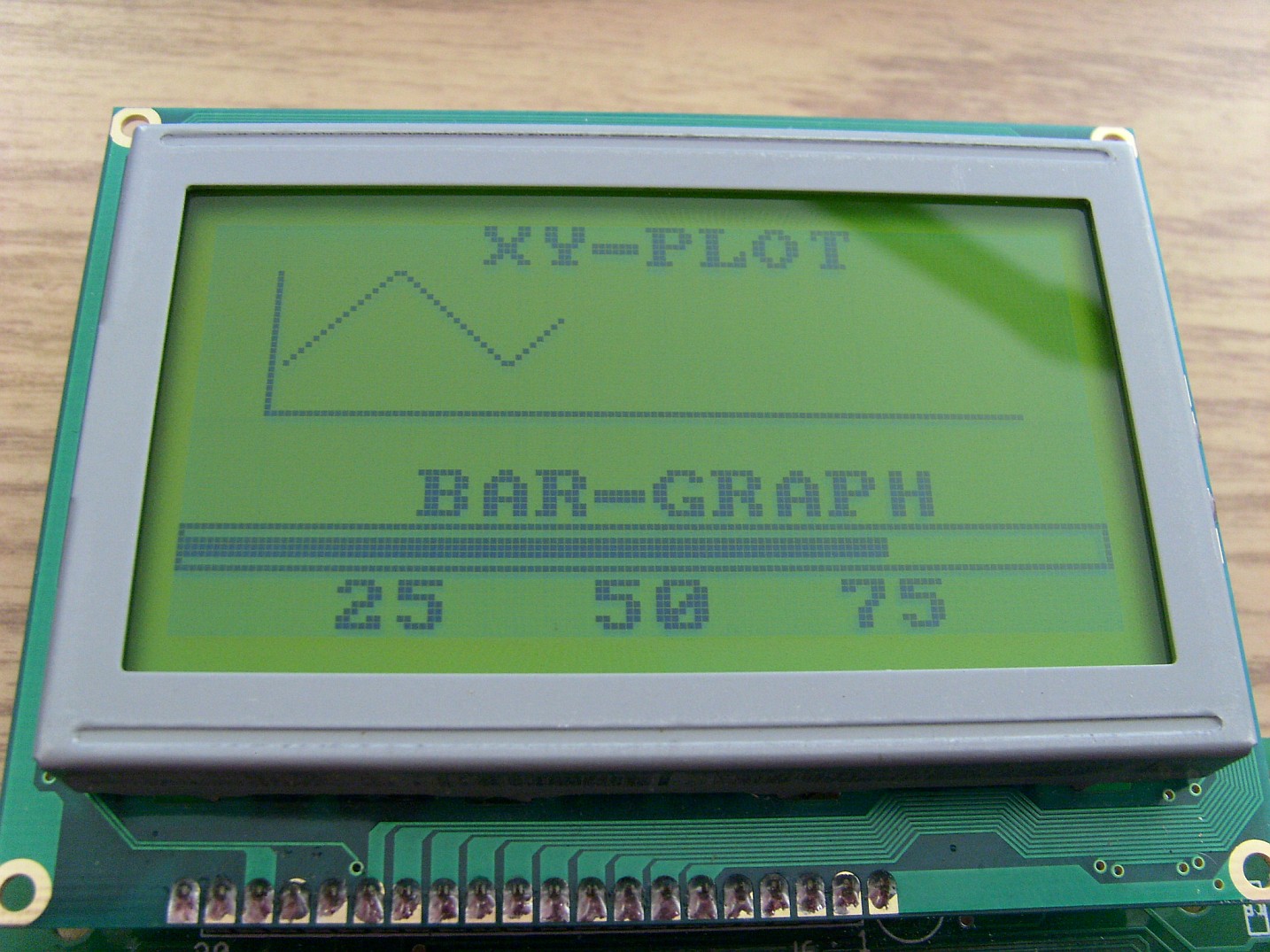

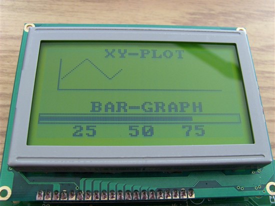

  • @Amit,
    Indeed that "equivalency beckons" - yet "can of worms" soon follow - and overwhelms - I guarantee that.
    I've designed/sold over 50K of similar 128x64 Lcd module.  No bit banding is needed for 8 bit data bus - and unlikely for RS, R/W & E strobe.  All can be achieved quite easily via standard Driver Lib - our group has done that for years.
    Here two (proving) photos - one of poster's desired (size) display running under LM3S811 & the other one of our software & display (only) deliveries (on an LX4F) - developed for medical client  who (got to "enjoy" Agency approvals) - as we often are "component only providers."   Big seller - throws off cash even today...!  While we used (some) direct register - all of our "proof of concept" was done (just) w/Driver Lib - and you see results...  Bottom photo "cropped" per legal...(& larger display)
