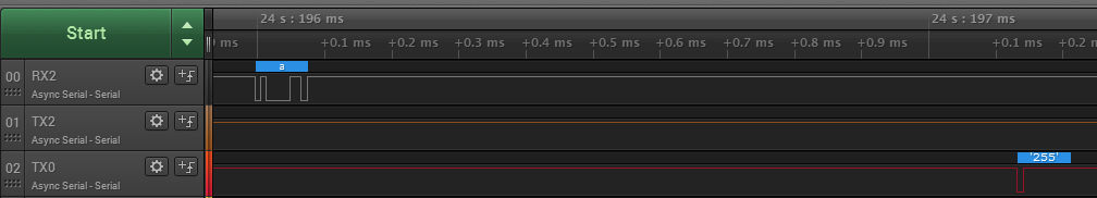

  • Many thanks for your quick response.
    My problem is this: I have to interrupt for the RX 2, when receiving a character in RX2 want to save in "data" and immediately after writing in TX0. But when I write in TX0 the value is always 0xFF!
    Sending the output read by a logic analyzer.
    Write "a" but I read "0xff"?
    Best regards
    Vitor

  • Hello Vitor,
    It looks to be a baud rate problem. The UART-2 is configured for 38200 bps. This would be a total time of 261us for sending one character. The LA plot shows a value less than 100us(~80us). This would be synonymous with 115200 bps. I bet the TX is not configured correctly.
    Amit
  • OK had the uart0 baud 115200, and the uart2 baud 38200. Uart0 and UART2 to 38200 and now works correctly. I do not have much experience with microcontrollers from TI, come from micro****  ... TI is currently much more stable...
    Thank you very much for your help!
