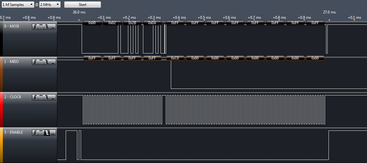

  • Ok I made some changes and now I see the outputs on the logic analyzer and the code does not hang.
    Just to confirm the process:
    1) Empty the RXFIFO
        while(SSIDataGetNonBlocking(SSI0_BASE, &pui32DataRx2[0]))
    2) Send 4 Bytes and wait for SSI to finish transferring
        for(ui32Index = 0; ui32Index < 4; ui32Index++)
            SSIDataPut(SSI0_BASE, pui32DataTx2[ui32Index]);
        while(SSIBusy(SSI0_BASE))
    3) Empty the RXFIFO
    4) Send 8 dummy bytes while receive 8 bytes
        for(ui32Index = 0; ui32Index < 8; ui32Index++)
        	// Put dummy bytes out to read bytes in
        	SSIDataPut(SSI0_BASE, 0);
            // Receive the data using the "blocking" Get function. This function
            // will wait until there is data in the receive FIFO before returning.
            SSIDataGet(SSI0_BASE, &pui32DataRx2[ui32Index]);
            // Since we are using 8-bit data, mask off the MSB.
            pui32DataRx2[ui32Index] &= 0x00FF;
            // Display the data that SSI0 received.
        	UARTprintf("'%i' ", pui32DataRx2[ui32Index]);
    Is this correct?
  • Hello Stephen
    Yes, it is...
    Amit

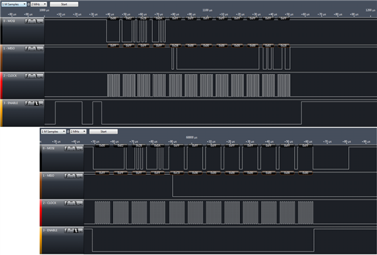

  • Hi Amit
    I do have one additional question related to all this.
    I used a logic analyzer to check the timing of the messages and it appears that the TIVA takes a very long time between bytes (5ms) compared to Arduino (2us).
    I'm running a very simple for loop in main... why does it take so long?
  • Hello Stephen,
    Can you please let me know what the System Clock and SSI Baud Clock are? Also in the diagram where do you see the time between bytes (you can mark it up in the snapshot).
    Also a publish of your full code would be rather useful
    Amit
  • Hi Amit, thanks for the quick reply
    In the picture I sent you can see that the top image shows the 12 bytes being sent without much delay. In the bottom image has long delays between each byte sent. The time scale is shown at the top bar of each image.
    SSI clock is at 1MHz and System Clock is at 120MHz
    Here is the code:

  • Hello Stephen
    The long delay is because of the slower UARTprintf. My suggestion would be to comment the same out, increase the baud rate to 60 (SSI supports upto 60MHz on SSI Master side) instead of 1 if the external slave device supports, or else to the maximum the slave device can support.
    Amit

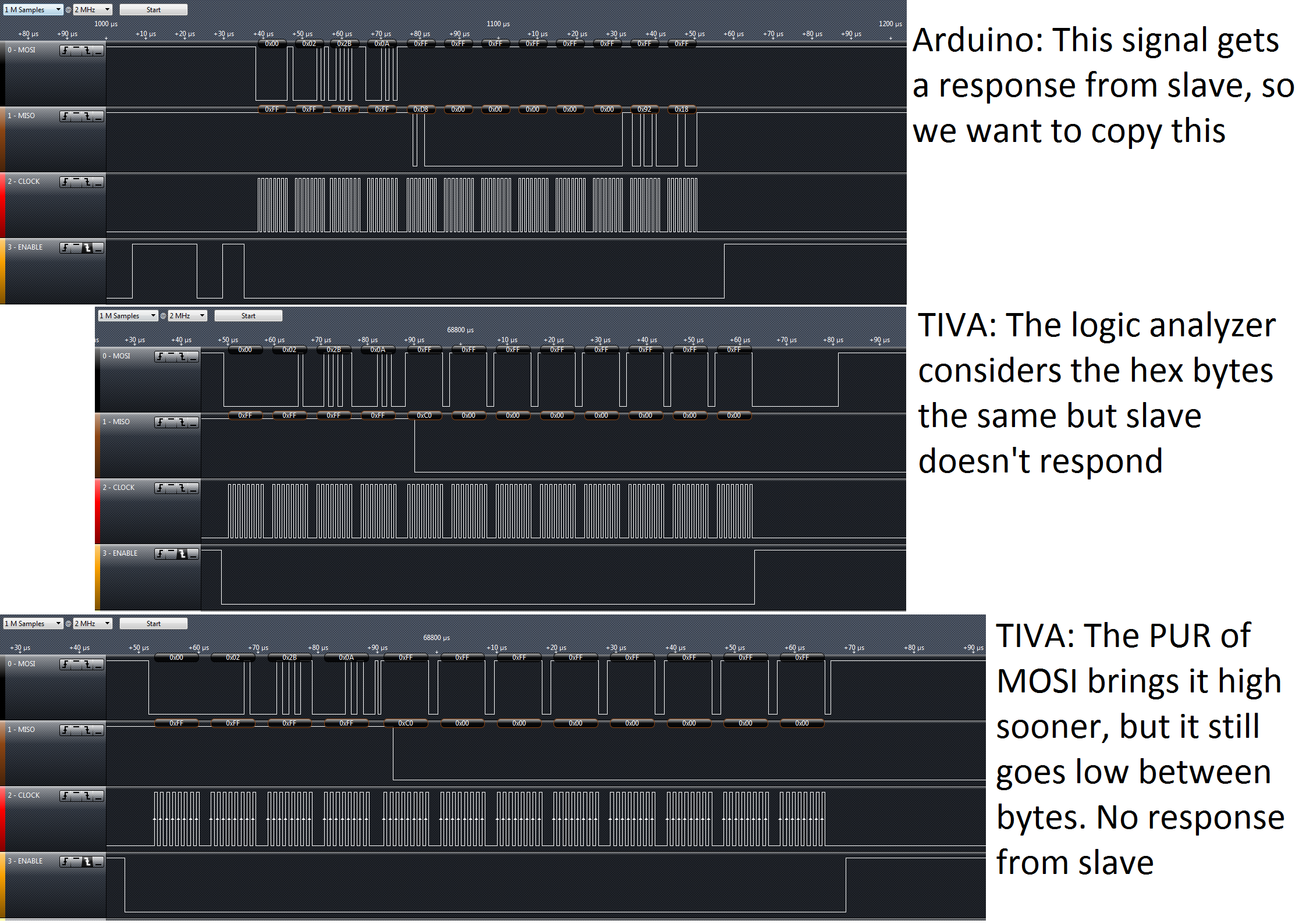

  • Wow very good catch! Much better now
    For some reason, slave still not replying to me.
    Is there a way to set MOSI high like in the top picture? I'm trying to make them identical

  • Hi All,
    I'm not quite sure what Fss has to do with anything since I am not using that pin at all...
    I'm using a GPIO as CS(Enable) to the slave.
    I've attached the picture to show that PUR does do something to the MOSI (it pulls it up earlier at the end, but not between bytes)
    Maybe you guys will think of something I missed
    Stephen

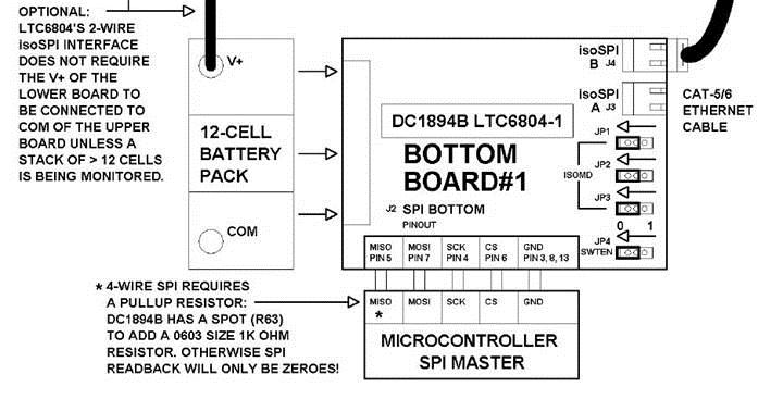

    The data sheet of the chip is somewhat contradictory - while at the beginning specify for SPI either mode 0 or mode 3, for the master chip is mandatory the mode 3, as expressely specified on page 31 and repeated on page 35.
    Also, on page 31, there is a mention stating the MOSI/MISO pins are open drain, so some pull-ups are needed.
    The programming guide states the possibility to have unresponsive devices due to wrong clock phases at 1MHz, suggesting to use 100KHz - maybe at the least at the beginning, until all is set up correctly.

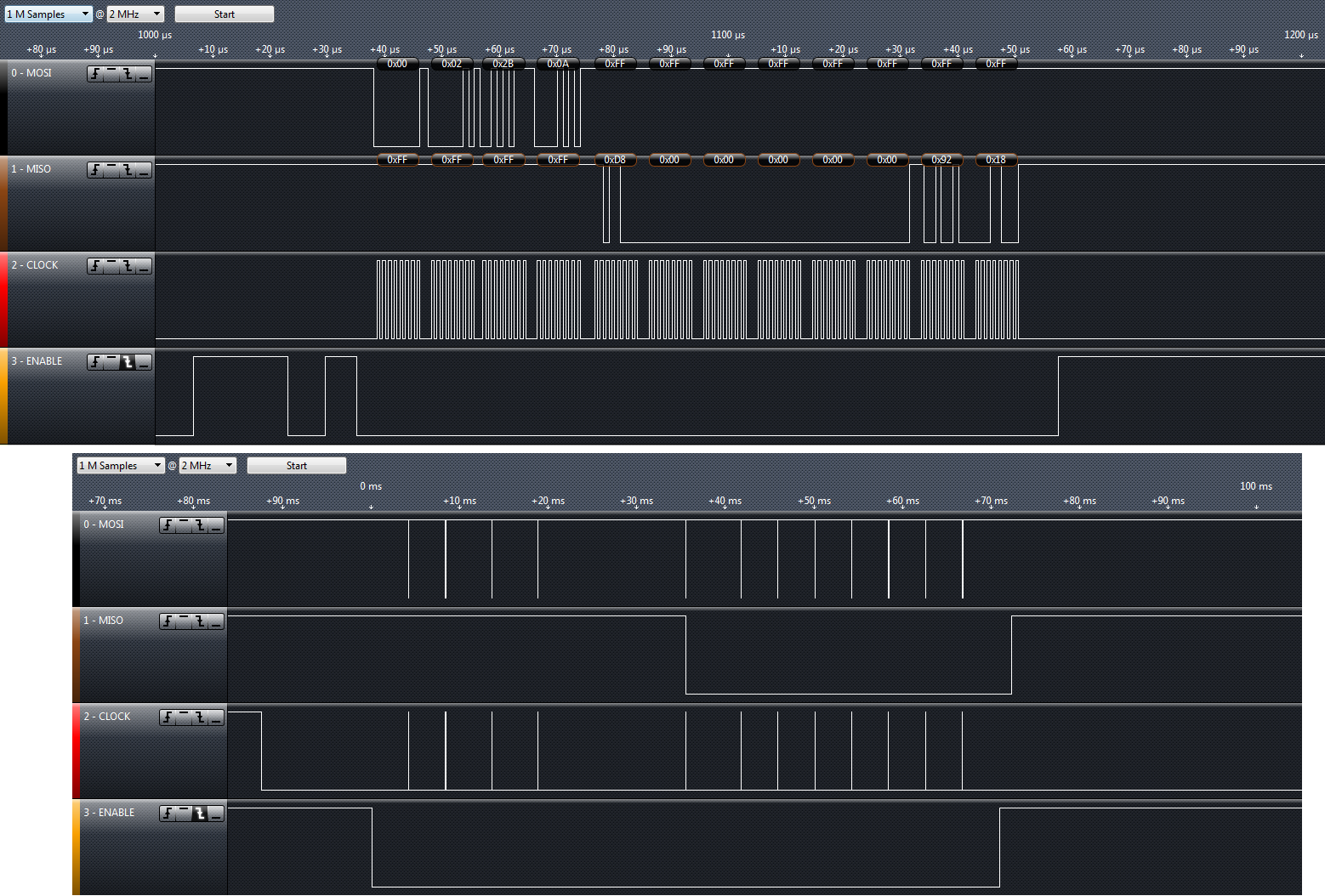

  • Hi Amit,
    I've tried using GPIO to pull MOSI up. It doesn't do it as long as its being accessed by ssi. I believe it is a hardcoded part of SSI; maybe we can't change it? Linear Technology hasn't been very responsive in offering advice. I'm glad TI has better technical support.
    Hi Petrei
    I've tried all the configurations recommended by datasheet (Mode0, Mode3, SSI clock to 100kHz etc). I haven't added external pull up resistors because this board works with Arduino out of the box.
    Here is what TIVA looks like in Mode3 (notice it doesn't pull low between bytes but the clock is very close together for some reason. For the record, the Arduino SPI is Mode0 at 1MHz.
    Now the million dollar question guys..
    Is there any hardware differences that make a TIVA and Arduino so different? I am hooking up the exact same pins on TIVA as Arduino (VCC, GND, MISO, MOSI, SCK, CS) nothing else. I'm reading the exact same MOSI message from the Logic Analyzer(0x00 0x02 0x2B 0x0A 0xFF 0xFF 0xFF 0xFF 0xFF 0xFF 0xFF 0xFF). Why is the MISO returning valid data to Arduino but now TIVA?

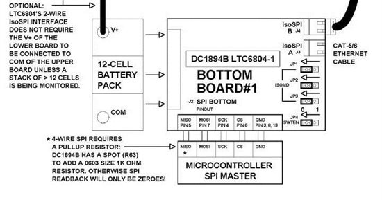

  • VregD is the digital supply internal to the device and there is no external access. 3.3V logic levels to the 6804 is okay because the 6804 DS pg 7 states logic high = 2.3V min and logic low = 0.8V max.
    The MISO pullup resistor should really tied between the uC’s VDD and SDI pins, which makes sense that MISO line should be the same logic level as the uC. So instead of adding a 1k Rpullup between 5Vreg and MISO on DC1894 R63, temporarily wire up with clip-to-clips a 1k between TM4C’s MISO pin and VDD pin. The readback is correct.
    The problem is now solved.

    I too, haven't used Beagle before. Just be aware that using the isoSPI requires an additional wakeup routine.
    1072.LTC6804-2_Programming_Guide_v20130814.pdf
    See page 4.
    To make things simpler, connect your Beagle pin directly to the LTC J2 header (VCC, GND1, SCK, CS, MISO, MOSI)
    I recommend looking at the Linduino source code (DC1942.ino) and LTC libraries (LTC68042.cpp)
