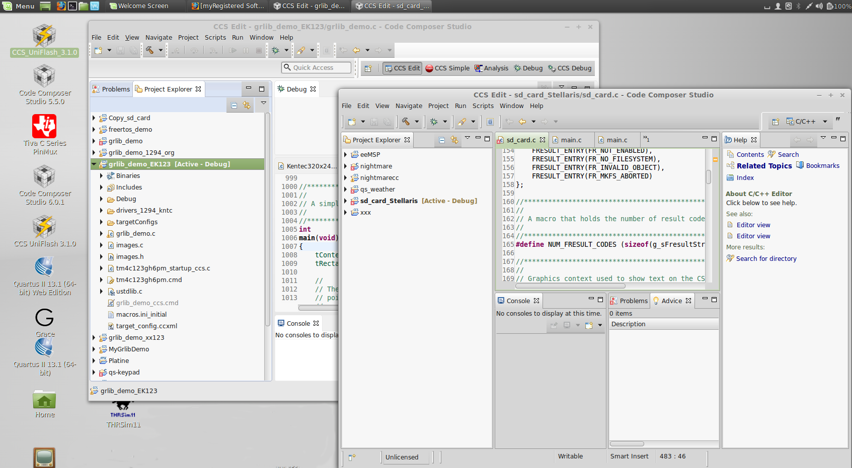

  •  Hi, I am using Linux Mint 17 64 bit so I patched all library and launched install script and all work fine. Same for 5.5 release.
     Release are not colliding so both version can run independently.
     see capture of desktop where on left is version 6.0.1 and right 5.5 running on same session.
