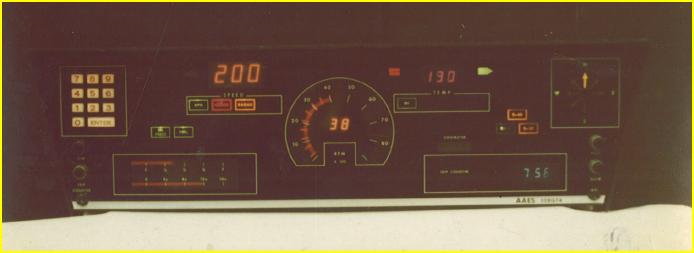

    Photo below reveals our deliverable for famed Italian auto maker (and racer) - digital dash - our (earlier) firm designed/developed more than 2 decades past.  (photo below may "pierce" assertion of "opinion/rumor!")  Displays included, "Planar Gas Discharge, Vacuum Fluorescent, & Incandescent."  That circular bar-graph (Tach - center of dash) appears as, "Liquid/flowing Fire" near 180° view angle - extremely compelling.  (we sold a ton to power stations - many "nuke.")
