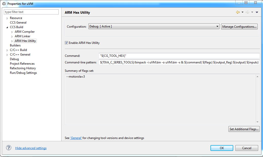

    I'm interested in a checksum checking version to verify the functionality through example if possible and to see if the mailbox setup is the same as I do with the application, etc.  I have been working with the bl_config.h already, but some of the documentation around checksum usage and setup is quite vague in the following items:
    1. How and where do the 8 32 bit words get placed in thet interrupt vector table as I get warnings adding it on the end
    2. proper setup of binpack.exe in the post build steps as I am not a fan of how I place it just prior to the *.s37 file generation in my build steps through a command line "&".
    I am more than willing to provide a screenshot of step 2 and an example code snippet to verify that I'm on the right track on the above items.

     Screenshot of build step:

    2. I generally run the binpack.exe as a command line utility and then use this modified firmware image.
    binpack.exe -i blink_test.bin -o blink_out.bin -a 0x2800
    I hope that clarifies. To double check if you run a binary reader like "od" in linux (must have cygwin version as well, then you will see the inserted 8 words in the original and the CRC updated 8 words in the modified file
    Amit
  • Thanks for the casting portion there. It is good to know I was on the right path with warnings, but I guess I will have to either go with a two step process or continue with the above command line method (which appears to work, but I was hoping for a better method). When work slows down (doubtful at this rate), I'll post a generic CAN bootloader example for 129x.
