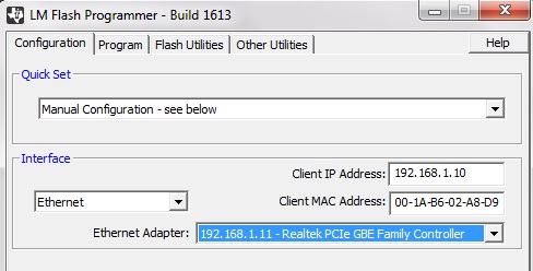

What I want:
To program the Ethernet enabled Stellaris evaluation board by LM Flash Programmer through Ethernet interface
What I am using:
- LM Flash Programmer
- EK-TM4C1294XL Launchpad
- Window 7 64 bit PC
What I have done:
- Allowed LM Flash programmer through Windows Firewall
- Disabled WiFI and enabled wired Ethernet connection. So now, there is only one active network called "192.168.1.11- Realtek PCIe GBE Family Controller" and I have chosen this to be the Ethernet Adapter.
- Entered Launchpad's IP and MAC address
What's the problem?
When the "Program" button gets pressed, the status bar changes to "Attempting to connect", but nothing happens after that.
