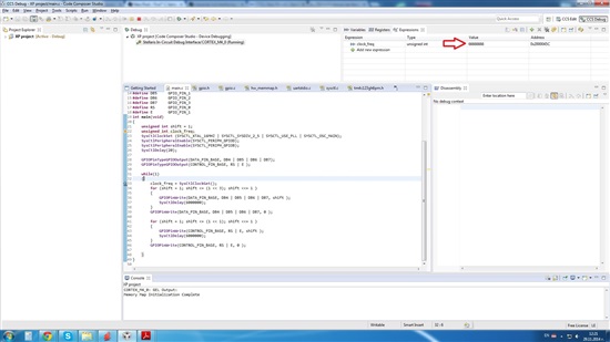

I consider that my clock frequency should be 80 000 000, but instead I get 66 666 666. I don't know why. Here it is my clock configuration line:
	SysCtlClockSet (SYSCTL_XTAL_16MHZ | SYSCTL_SYSDIV_2_5 | SYSCTL_USE_PLL | SYSCTL_OSC_MAIN);
And this is a screen shot of my debug session:

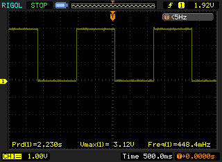

    And This is the scoped output:
    I still can't calculate my time delay properly.
    Looking to your picture there is a good delay interval  (2 divs at 500.0ms) between pulse changes. If you need the period to be 1 second, then there are two such time intervals, defined by the delay function, so a small calculation will solve...

    I know how to attune my delay interval to match 1s. The problem is that I expect the frequency to be exactly 2Hz not 2.23Hz as you can se on the picture. I know that the SysCtlDelay function takes 3 clock cycles for each iteration. Thats why I divided the system clock freq by 3, so to achieve exactly 1 sec delay interval. Excuse my poor English I hope you understand my point.
  • Hello Radoslav,
    Above 40MHz the prefetch buffer is used and the manner in which the SysCtlDelay is placed in flash it can be across the prefetch buffer boundary causing an additional delay. The simplest thing to do is to run the system clock at 40Mhz and then see if the SysCtlDelay with the correct delay value gives 2Hz.
    Amit
  • Thanks Amit. Its OK now :)
