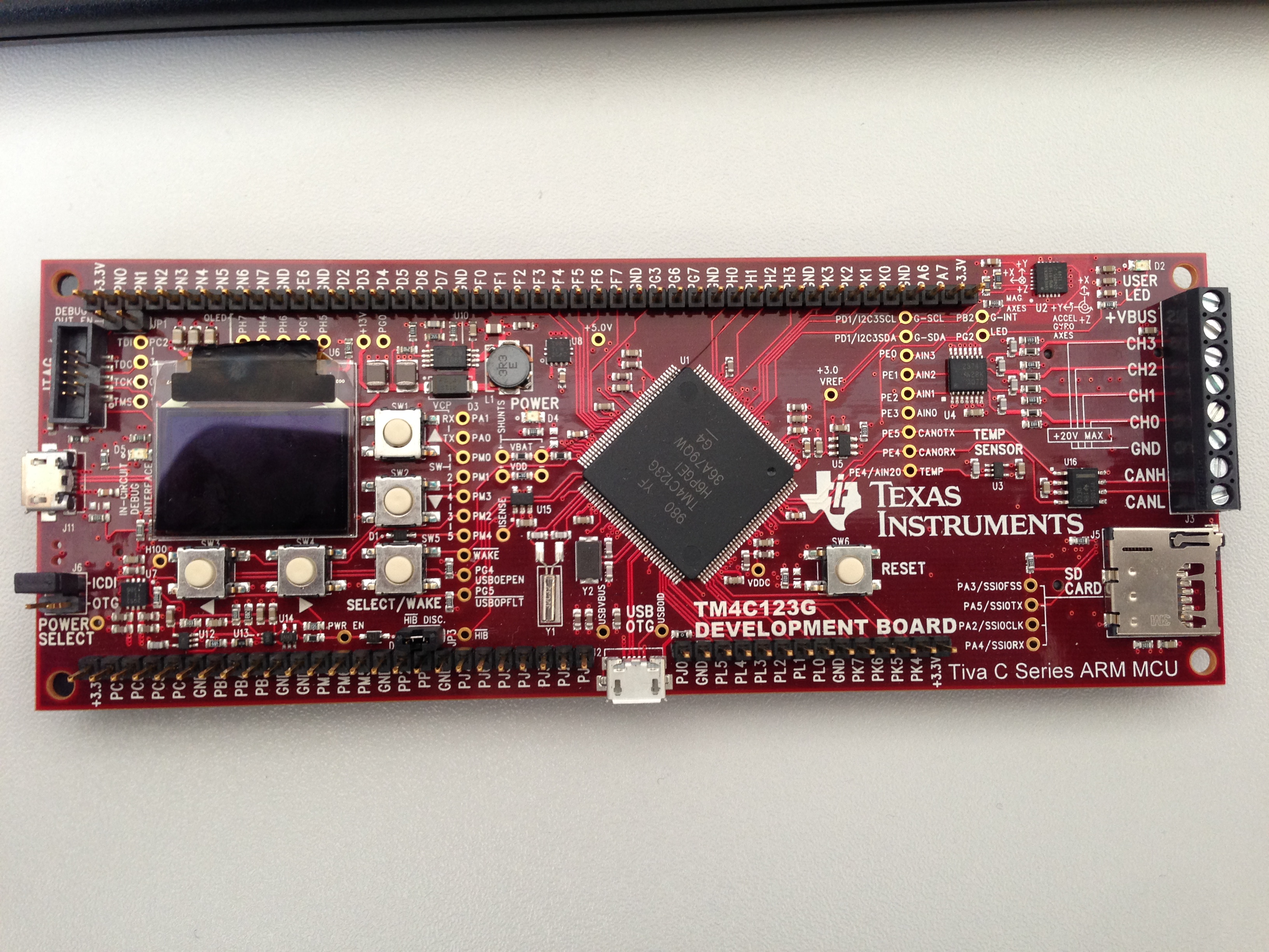

Hi Experts,
I am using the tiva dk-tm4c123g(H6PGEI36A79QWG4) board to set up multiple UARTs.
Generally speaking, the board is good with detailed output pins and easy to connect.
My question has two parts:
1. how do i setup UART2 in software level.
2. how do i have voltage for PD6(U2RX) and PD7(U2TX)?
I am eager to know why no voltage on PD6.7...
here is what I defined in source code:
#define GPIO_PORT_BASE GPIO_PORTD_BASE
#define GPIO_PIN_TX GPIO_PIN_7
#define GPIO_PIN_RX GPIO_PIN_6
#define UART_BASE UART2_BASE
#define INT_UART INT_UART2
#define SYSCTL_PERIPH_GPIO SYSCTL_PERIPH_GPIOD
I config the pins and interrupts to make UART2 to be working, maybe buggy but I leave the question later.
Currently, first step, I have to have voltage for PD6.7.
I am wondering if any "jumper" needs to be used to get voltage on pin?
Cheers,
mh

  • Hi Luis, thanks for your additional info.
    I read your blog and realize that the board we are using is different.
    In my case, I think I have hardware difficulty. I call it difficulty since I think the hardware is fine but there should have tricky "jumper"(hardware) or "config"(software) to activate UART2-7.
    Let me give you an example:
    If unplug the Bluetooth module(PAN1323TU) from the board, UART1(Tx. Rx) loses voltage, but if I replug the Bluetooth, UART1 works again. I think it's both sw and hw synergistic working.
    anyone could guide me how to make those GPIO port "on power"? I think should be a easy solution but I just didnt find the entry.
    Cheers,
    mh

  • Hello Minghua,
    Couple of pointers here in the code from your post.
    GPIOPinConfigure(GPIO_PD6_U2RX);
    GPIOPinConfigure(GPIO_PD7_U2TX);
    // Unlock PD7
    HWREG(GPIO_PORTD_BASE + GPIO_O_LOCK) = GPIO_LOCK_KEY;
    HWREG(GPIO_PORTD_BASE + GPIO_O_CR) |= 0x01;
    1. The GPIO needs to be unlocked first and then GPIOPinConfigure function called
    2. The GPIO to be unlocked is PD7, whereas your code is unlocking Pin-0 or PD0. You may want to review the changes.
    Amit

  • Hello Mh,
    And why is the AFSEL being cleared for the Port-D Pins? This is incorrect. They must be set,
    uint32_t ui32AFSELGPIO = HWREG(GPIO_D_AFSEL);
    HWREG(GPIO_D_AFSEL) &= 0x00;
    You can instead use
    GPIOPinTypeUART(GPIO_PORTD_BASE, GPIO_PIN_6 | GPIO_PIN_7);
    Amit
  • Hi Amit,
    I think your suggestion again makes effect.
    I commented the AFSEL related out and finally I have the pin voltage.

    I live in Portugal BTW, so yea, big difference
  • Hello Luis
    You may be right. The delay loop is missing after a direct HWREG write to the RCGC register. A better solution would be to wait for the PRGPIO register to show if the peripheral is ready for access, instead of a delay loop.
    Amit
