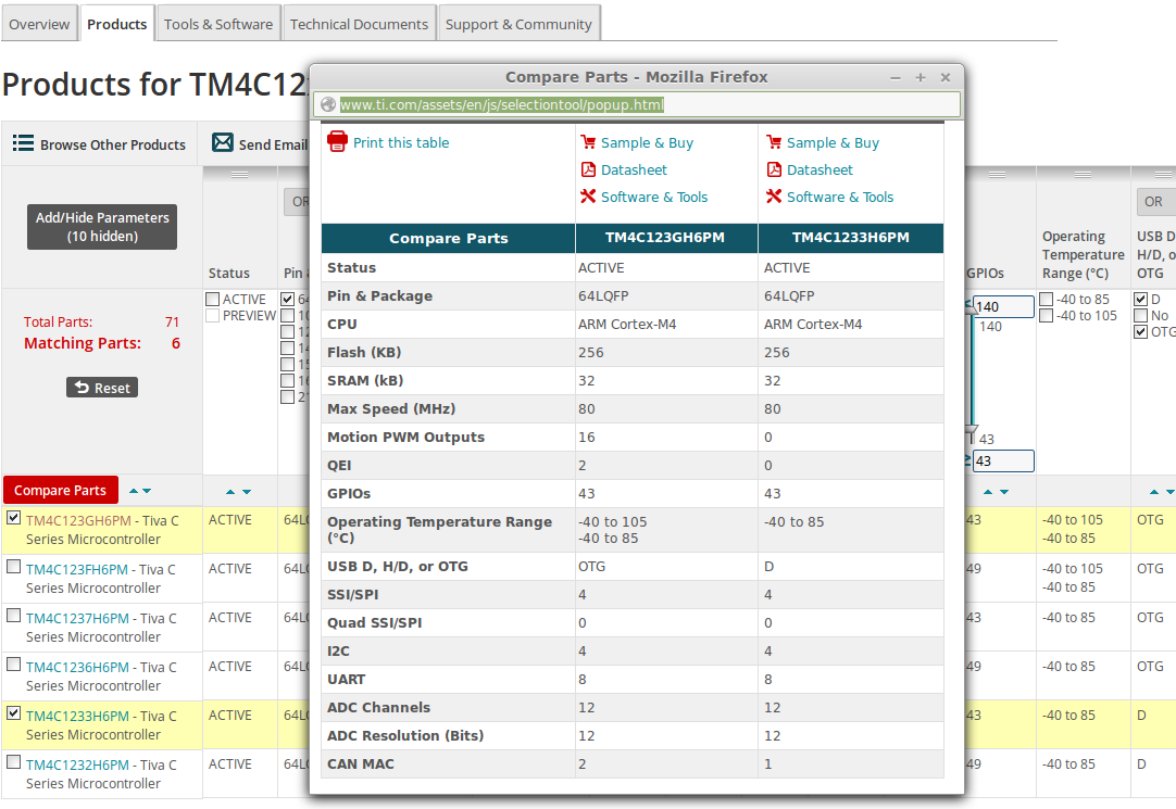

     Marcel, when you get more aquainted with family then you can choose chip at a glance but for now take an eye to this picture comparing new device to old device, also if you got to link of EK-LM4F120XL you get more information on new Launchpad, old miss PWM Motion, 1 CAN Channel USB is device only
     NEW Launchpad vs OLD Launchpad

    See the equivalent names in the picture below:
    Petrei

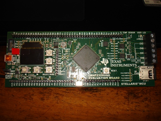

     Hi Luis, this is a now picture of old Stellaris equivalent to the one you pointed to, see connector on left has just 6 screw, and no can signal, the new one has two more screw CANH, CANL and is marked TIVA, processor is the same with name changed.
     Launchpad when stellaris was got away get upgraded from LX120->TIVA
    LM4F120H5QR -> TM4C1233H6PM pin to pin replacement and functional equivalent.
     As premium new TIVA LP got equipped with a top series of 64 pin TM4C123GH6PM. So old name for this was LM4F230H5QR -> TM4C123GH6PM and the Launchpad are same PCB with just silkscreen and few variant and new <TIVA> processor TI claim be same silicon.
     On new TIVA LP also the ICDI is a TM4C123GH6PM where it was more appropriate a smaller 1233 member. I suppose this is the most popular one.

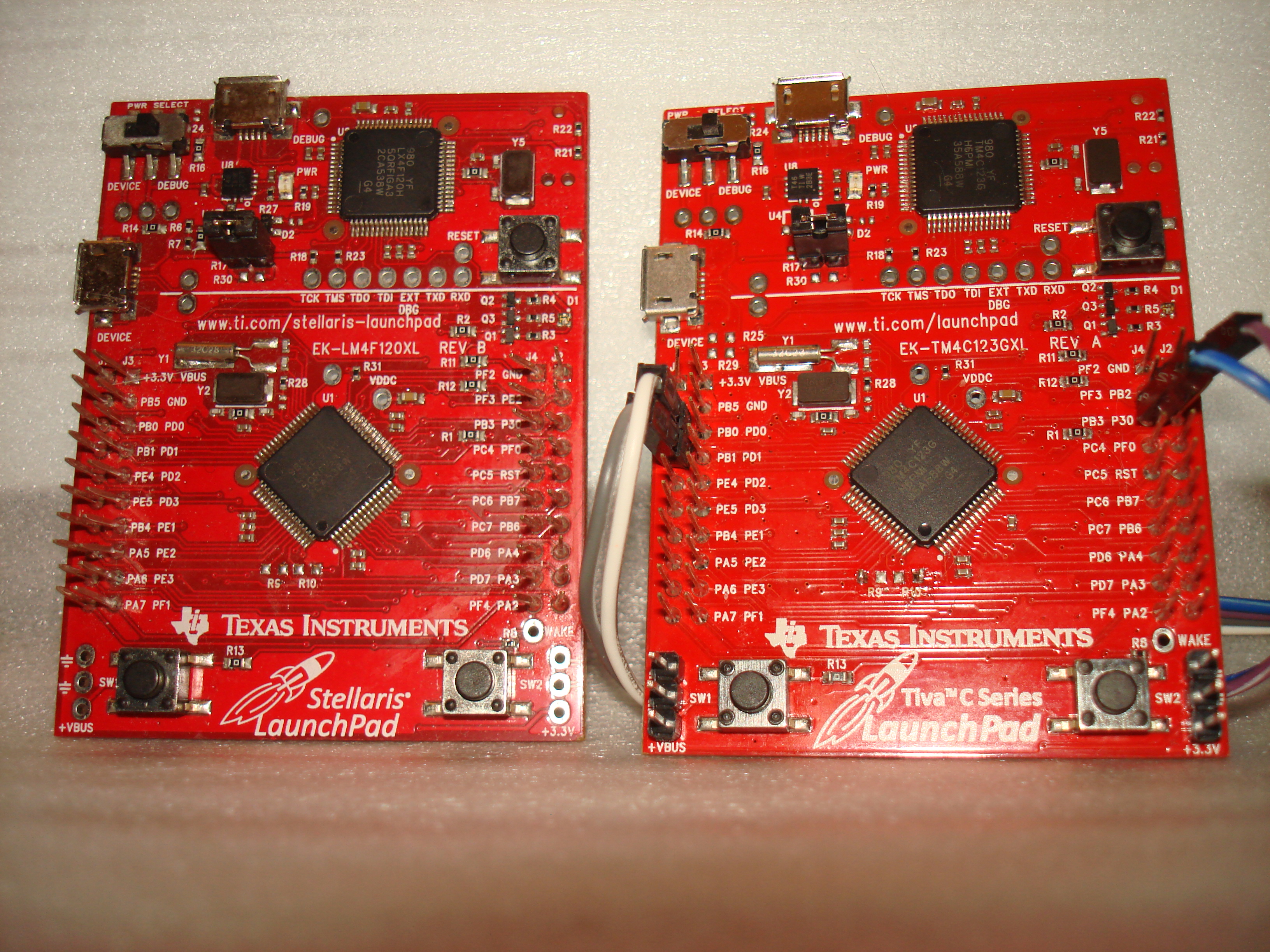

     I got an LX120 board from cardboardbox, so here the final overkill a comparison picture of old and new hand in hand.
     Of course zero resistor are removed from Stellaris and "tomb stoned" (CB1 copyright) on TIVA.
     I think this can clear all other doubt how old launchpad was.
  • Roberto,
    If one of those truly is "cardboard" - you have job in "special effects Dept". - most any movie studio!
    While we appreciate your kind mention - "tombstone" - though superbly descriptive - was invented/copyrighted by others - we (may) have been first to use it here...
    Certain of our clients - having been badly burned by those (delightful) 0-ohmers - have simply "Drilled them out" to prevent any chance of their (mistaken) re-seating...
     I prefer them left on military  "stand up" to educate them prevent damages.
     In answer to your observation a similar tool has to be installed both part to signal one to other failures too:
