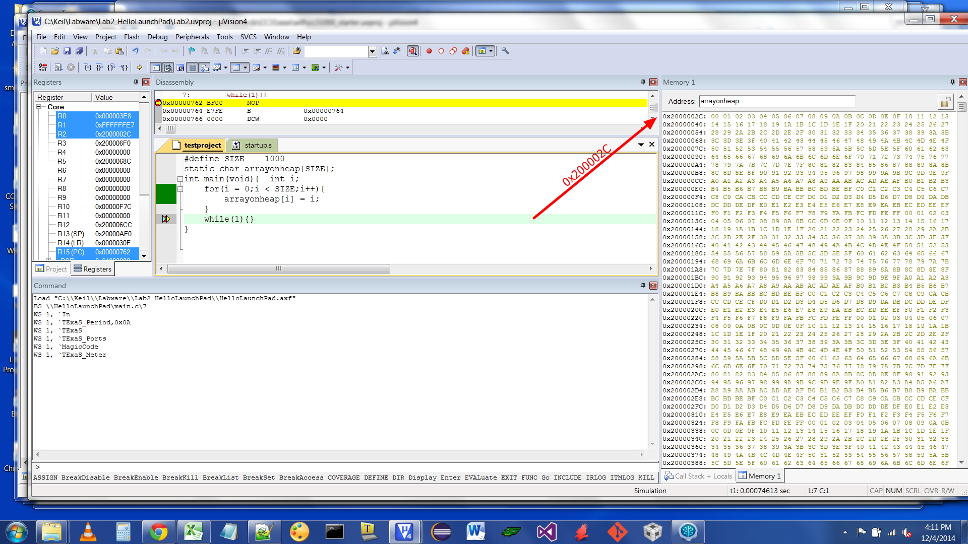

  • Looks like it could be the printf using UART.  I did some test just viewing memory and not printing and I am storing plenty of chars in memory.
    Pointer to char size[TEST_SIZE];
    char *sizeptr = size;
    Start Address        TEST_SIZE         STORED
    20004190              (1200)                   1199
    20003E70             (2000)                    1999
    20003A88             (3000)                    2999
    20001F00            (10000)                   10047
    2000463F (end address)
    Possible start limit address (max char stored, not sure about this, but when I go lower than 20000001 I get error during runtime.
    20000001 - 17,982
    Your RAM area starts at 0x20000000 and has 32KB.
    Seems you used non-conventional accessing, starting from top - could you better post some code snippet instead? All memory allocations are managed by the linker.
    Petrei
  • If it is 32kb, divided by 8 bit char, then max is 4k chars.  I can get up to 2500 characters or so in the array.  That could make sense.

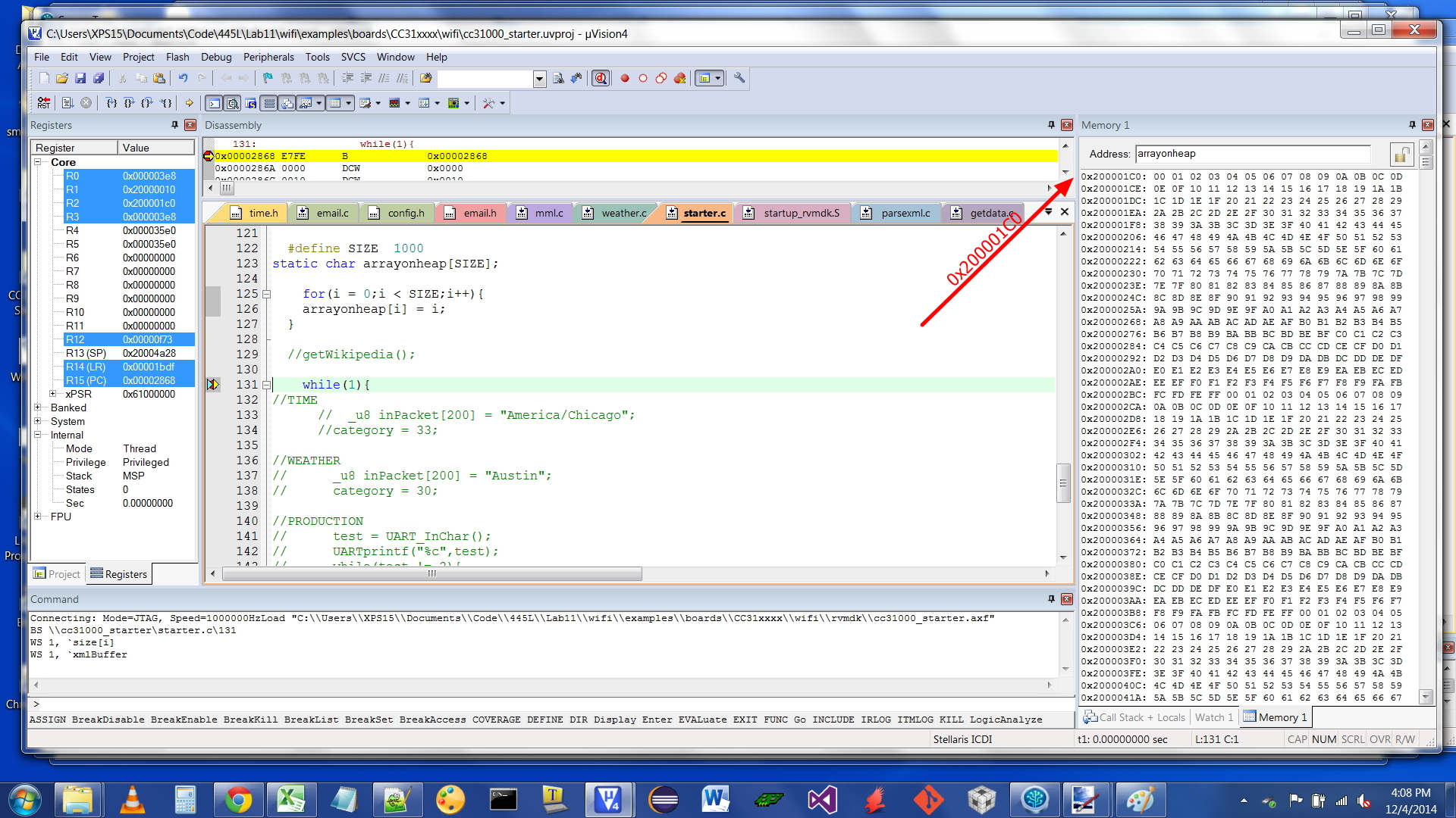

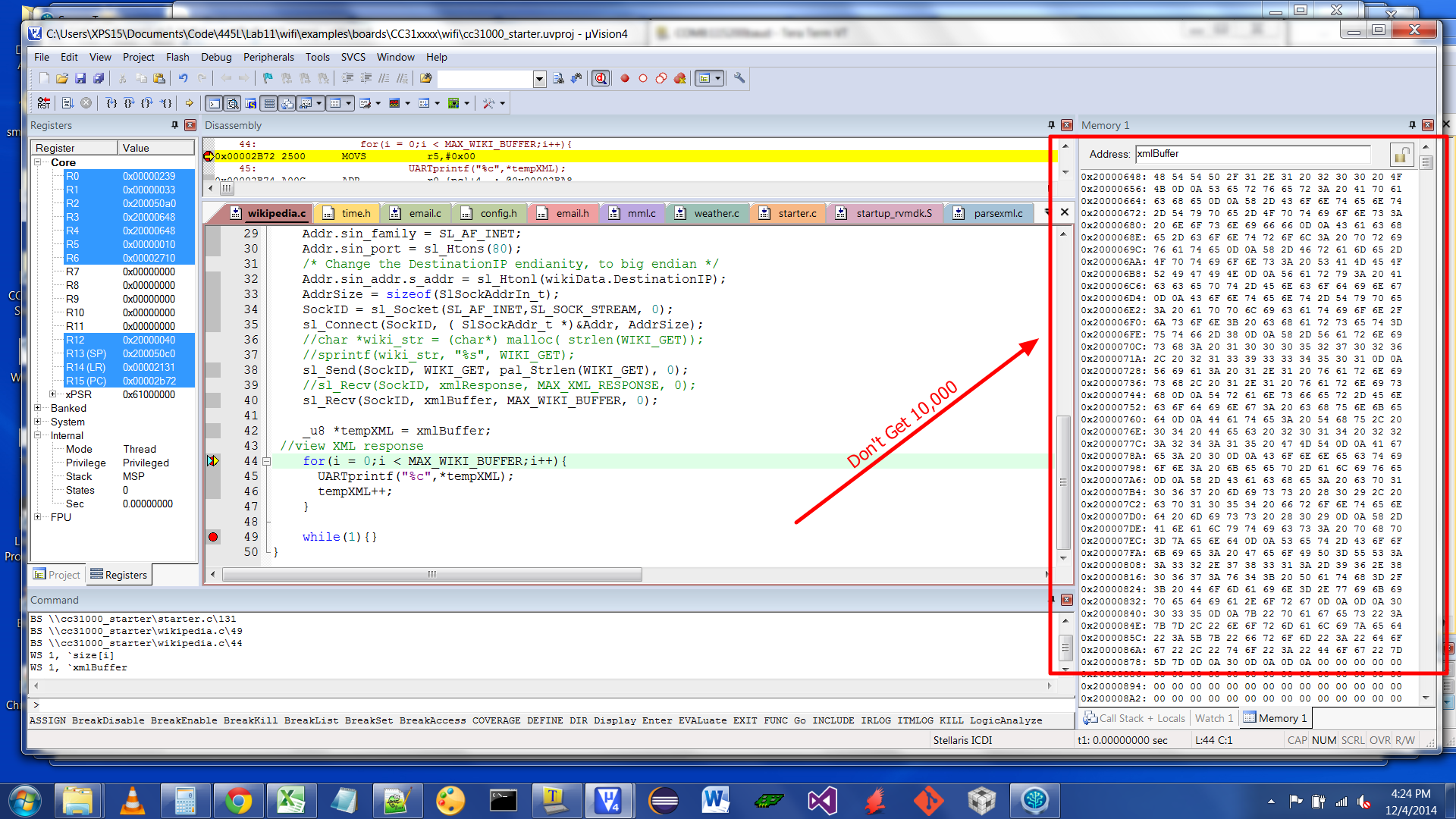

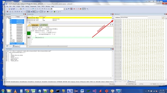

  • I am not using const because I need to change the contents at runtime.  I am not allocating on the stack.  I am using static char arrayOnHeap[SIZE].  Here are some screenshots from my current project and some testing.  The allocation works in a test project, in my project without other code, but does not work where I need it.  Here is the code from the file where the allocation does not work.

  • Noticed I left my malloc in the previous code.  Here is the code that does still does not work.  I am running to a breakpoint before I print.
