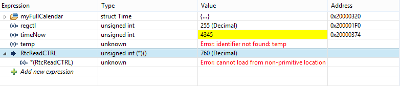

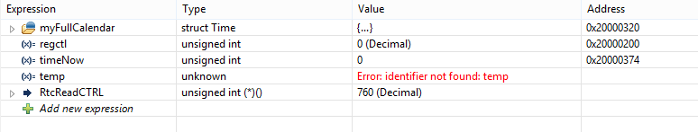

I want to learn how to use i2c protocol on ti launchpad. I have an rtc ds1307. I have setup a project. I want to setup the control register for1 Hz square pulse that i can see blinking on the pcb.
After a lot o effort that the program was stacking into the check of i2cmasterbusy() function i enabled the loopback mode and the program unstacked.
The problem was not solved tho. In the debug mode the i2creceive funtion gives price of 760  in decimal.the variable that is set to the retrurn of the function goes from zero to 255. I will give you the 2 photos of the program and the whole program. If you find any problem please tell me what i do wrong.
The  photos:

	regctl=RtcReadCTRL();
	while(1) {
		if(GPIOPinRead(GPIO_PORTF_BASE, GPIO_PIN_2))  {
			GPIOPinWrite(GPIO_PORTF_BASE, GPIO_PIN_2, 0);
			delayms(100);
		}else{
			GPIOPinWrite(GPIO_PORTF_BASE, GPIO_PIN_2, 4);
			delayms(100);
Can you give me the error???

  • Hello Kyriakos
    The regctl which holds the value from the I2CRecieve shows the values as 255 or 0 between the two snapshots? Can you explain the same?
    Also it seems that the value of RTCReadCtrl is being read as an address. Can you check in the map file the location in flash where the function is being located?
    Amit
  • when the program starts the value is 0 and when the program goes into while loop it gets the value 255.
    The registrer address for the control is 0x07 so i have to write to this address a value of 0x10 to get an 1Hz square pulse and this is the same value i am trying to read. what do you mean about checking in the map file the location in flash can you explain more in order to undestand? Thaank you.
  • Hello Kyriakos
    In CCS there is a map file which created which shows where the functions are placed in the memory. This would be created in the CCS project -> Debug directory by the name of YOUR_PROJECT_NAME.map
    It is a text file that can be opened in CCS. Search for the function name in the map file and the address at which the function is placed.
    Amit
  • There address is: 000002f9 RtcReadCTRL what can i understand by this?
  • Hello Kyriakos
    0x2F9 in decimal is 761. The Address of the function is 760 which matches up (remeber in Cortex M4 the LSB of the address is a byte incremented)
    Amit
  • Can you explain more? What does that mean about the return value 255? And how can i make it work properly?
    Where is the bug that makes the program not to send 0x10 and send 0xFF(255)?
    Your expression to watch is defined as unsigned int (*)() which is a pointer to a function returning unsigned integer. Defined as this, the debugger cannot execute your function and return to you 255 or whatever is the result.
    More, as you show, its address falls within the vector interrpts area so the question(s): did you defined the function RtcReadCTRL as interrupt vector ? Did you added a startup_xxx.c file to your project?
    Please specify the micro used and the tools.

    Sorry i  could not find a way to insert file and not media.How can i do it.I can also add the map file
    Your map file seems to be OK. Now related to your initial question, I think it is good to use something my_var=my_function() and to watch my_var instead of a pointer to function.
    As for inserting a .zip file, try inserting media (the second one, looking like a film and select uploading from your computer, disregard dimension - I tried and seems to upload, but not really inserted.
    Petrei
  • My basic question: is there any error on enabling the i2c protocol and in the way I call the receive and send functions in order to be logical to get this values? But more basic is this a good configuration ? ( it shouldn't be so hard :(.   )
  • Hello Kyriakos,
    The configuration of I2C is correct. As Petrei did mention, it is the manner in which the variable has to be read by the function and monitoring of the return value instead that of the function's address in memory map
    Amit
  • So let me get it clear. There is no problem in the initialisation of the i2c protocol, and there is not any problem on send and receive functions.
    But if there is no problem in the send and receive function the setCTRL and readCTRL functions should work correctly. Except that i have a led on the rtc.So if the correct value is set to the register i will understand it even if the readCTRL value had a problem. So since he conf is good is there any problem on the send and receive?
  • I have managed to make it almost work. I have reconnected the pullup resistors for thew sda and scl of the i2c and i have deleted the loopback function. I manage to read the register 0x07 before  writing to it and the value was 0x03.After this i wrote to the register the value 0x10 and then i read it back. The value was correct but it did not opened the square pulse. Though it was correct the value i read the pulse is not working. So is it any chance that the read was not good? I am giving a photo that in order to prove that the correct value for 1Hz square pulse is 0x10.
    Is it possible to read a correct value and still the register not to be set?
  • Hello Kyriakos
    Yes, the chance of reading the correct value and not seeing an output could be of the following reasons
    1. Is the OUT Pin connected to the Pull Up as described in the DS1307 data sheet
    2. Is the slave device some how faulty? Won't be surprised as it often happens...
    Amit
