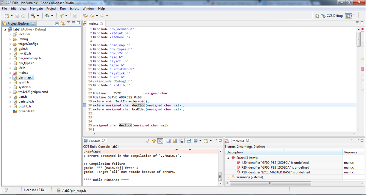

    But still I am getting following errors..
    "../main.c", line 46: warning #225-D: function declared implicitly
    "../main.c", line 61: error #20: identifier "GPIO_PB2_I2C0SCL" is undefined
    "../main.c", line 62: error #20: identifier "GPIO_PB3_I2C0SDA" is undefined
    "../main.c", line 65: error #20: identifier "I2C0_MASTER_BASE" is undefined

  • Hi,Sir
    Following is compilation log of my code:::
    **** Build of configuration Debug for project lab2 ****
    "C:\\ti\\ccsv5\\utils\\bin\\gmake" -k all
    'Building file: ../main.c'
    'Invoking: ARM Compiler'
    "C:/ti/ccsv5/tools/compiler/arm_5.0.4/bin/armcl" -mv7M4 --code_state=16 --float_support=FPv4SPD16 --abi=eabi -me -g --include_path="C:/ti/ccsv5/tools/compiler/arm_5.0.4/include" --include_path="C:/ti/ccsv5/tools/compiler/arm_5.0.4/include" --include_path="C:/ti/TivaWare_C_Series-2.1.0.12573" --include_path="C:/ti/TivaWare_C_Series-2.1.0.12573" --diag_warning=225 --display_error_number --diag_wrap=off --preproc_with_compile --preproc_dependency="main.pp" "../main.c"
    "../main.c", line 48: warning #225-D: function declared implicitly
    "../main.c", line 63: error #20: identifier "GPIO_PB2_I2C0SCL" is undefined
    "../main.c", line 64: error #20: identifier "GPIO_PB3_I2C0SDA" is undefined
    "../main.c", line 67: error #20: identifier "I2C0_MASTER_BASE" is undefined
    3 errors detected in the compilation of "../main.c".
    >> Compilation failure
    gmake: *** [main.obj] Error 1
    gmake: Target `all' not remade because of errors.
    **** Build Finished ****

  • Hi Amit Sir,
    Thanks for your reply ,
    After making the changes recommended by you as well as by the ccs forum ,previous errors have been removed.But ,Now I am getting errors related to UART.
    Please do help me out..
    My present compilation log is...
    "C:/ti/ccsv5/tools/compiler/arm_5.0.4/bin/armcl" -mv7M4 --code_state=16 --float_support=FPv4SPD16 --abi=eabi -me -g --include_path="C:/ti/ccsv5/tools/compiler/arm_5.0.4/include" --include_path="C:/ti/TivaWare_C_Series-2.1.0.12573/driverlib" --include_path="C:/ti/ccsv5/tools/compiler/arm_5.0.4/include" --include_path="C:/ti/TivaWare_C_Series-2.1.0.12573" --include_path="C:/ti/TivaWare_C_Series-2.1.0.12573" --define=ccs="ccs" --define=PART_TM4C123GH6PM --define=UART_BUFFERED --diag_warning=225 --display_error_number --diag_wrap=off --preproc_with_compile --preproc_dependency="main.pp" "../main.c"
    'Finished building: ../main.c'
    'Building target: lab2.out'
    'Invoking: ARM Linker'
    "C:/ti/ccsv5/tools/compiler/arm_5.0.4/bin/armcl" -mv7M4 --code_state=16 --float_support=FPv4SPD16 --abi=eabi -me -g --define=ccs="ccs" --define=PART_TM4C123GH6PM --define=UART_BUFFERED --diag_warning=225 --display_error_number --diag_wrap=off -z --stack_size=512 -m"lab2.map" --heap_size=0 -i"C:/ti/ccsv5/tools/compiler/arm_5.0.4/lib" -i"C:/ti/ccsv5/tools/compiler/arm_5.0.4/include" --reread_libs --warn_sections --display_error_number --diag_wrap=off --xml_link_info="lab2_linkInfo.xml" --rom_model -o "lab2.out" "./main.obj" -l"libc.a" "C:/ti/TivaWare_C_Series-2.1.0.12573/driverlib/ccs/Debug/driverlib.lib" "../tm4c123gh6pm.cmd"
    <Linking>
    undefined first referenced
    symbol in file
    UARTStdioInit ./main.obj
    UARTprintf ./main.obj
    error #10234-D: unresolved symbols remain
    error #10010: errors encountered during linking; "lab2.out" not built
    >> Compilation failure
    gmake: *** [lab2.out] Error 1
    "../main.c", line 74: warning #225-D: function declared implicitly
    "../main.c", line 84: warning #225-D: function declared implicitly
    "../main.c", line 86: warning #225-D: function declared implicitly
    "../main.c", line 114: warning #225-D: function declared implicitly
    "../main.c", line 119: warning #225-D: function declared implicitly
    "../main.c", line 125: warning #225-D: function declared implicitly
    "../main.c", line 130: warning #225-D: function declared implicitly
    <Linking>
    symbol in file
    ROM_FPULazyStackingEnable ./main.obj
    ROM_GPIOPinConfigure ./main.obj
    ROM_GPIOPinTypeGPIOOutput ./main.obj
    ROM_GPIOPinTypeUART ./main.obj
    ROM_SysCtlClockSet ./main.obj
    ROM_SysCtlPeripheralEnable ./main.obj
    UARTStdioConfig ./main.obj
    >> Compilation failure
  • Hello Mahavir,
    I think you have misread me...
    Amit Ashara said:
    Another suggestion would be to import one of the existing TivaWare examples like uart_echo and then updating the main file with your code, That will help get rid of unwanted setup issues.
    The suggestion was to import an existing project and copy your code into the project's main code, not the other way around...
    Amit
