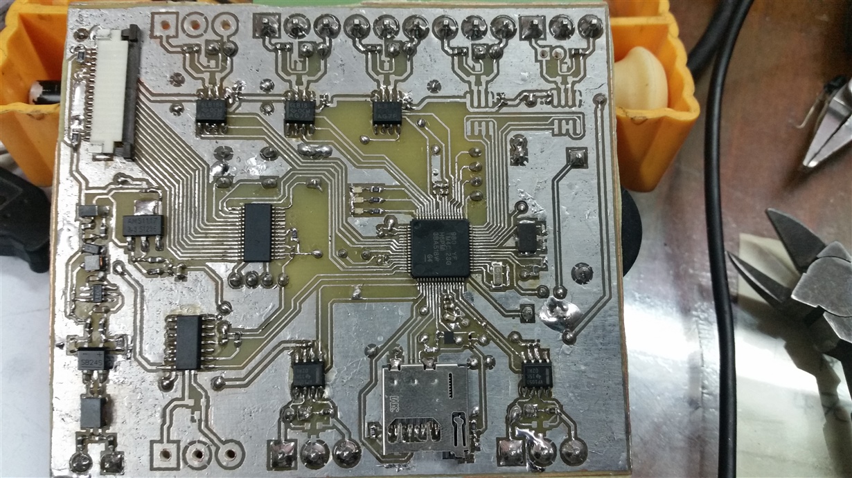

I have a problem with CAN module on Tiva C microcontroller, I’m using the following configuration:
1)  Using TM4C123GH6PM microcontroller with both CAN0 and CAN1 connected to two CAN transceivers sn65hvd1050
2)  Since I don’t have CAN cable I’m using 1 meter pair from a CAT6 cable and replaced the 120 ohm resistor with 100 ohm to match the cable
3)  The board is based on my design however the CAN section of the board is based on the TM4C123G Kit from TI
4)  I’m using the CAN example for the TM4C123G Kit after doing the required modifications to work with my processor TM4C123GH6PM
5)  My target is to be able to send CAN messages from either modules (CAN0 and CAN1) to the other as a first step for further development

I never got a correct communication I always get the error reg “ui32Status” with a value of 0x000000E5
I did several trials to solve this error but none of them worked, I don’t know what shall I do or how can I get a better understanding of the problem to solve it.

    The Error Status of 0xE5: Bus Off, error passive state for continuous more than 127 errored frames and bit-0 error where instead of 0, the line is detected as 1.
    I do not have your board schematic nor the full view of the code. What I may suggest is to see when CAN controller is sending the data, then does it receive the same on the CANRX pin with and w/o the cable connected, to see if the Transceiver is working.

    You pointed to the transceivers, although I was sure they are properly configured and powered, and checked it before, I found great mistake, shame on me, I mixed up the CAN Tx and CAN Rx so it was normal that nothing works.
    I corrected the board (by cutting the wrong tracks and reconnect them again properly) and tested the code with the following results:
    1)      First trial failed
    2)      Changed the “CANBitTimingSet” to “CANBitRateSet” with bit rate of 50K à it worked

    PS: I’m attaching the photos of the prototype board that I’m doing my development, it was printed and soldered in my lab.
