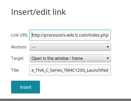

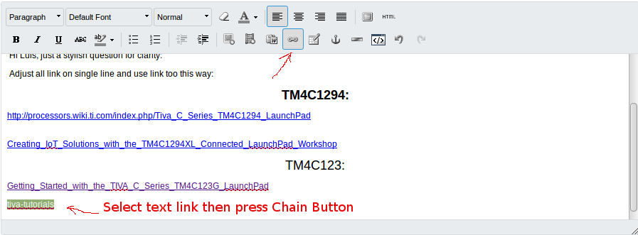

     Hi Luis, just a stylish hint for clarity:
     Adjust all link on single line and use link too this way (if you like or forget and use your preferred style instead):
    TM4C1294:
    http://processors.wiki.ti.com/index.php/Tiva_C_Series_TM4C1294_LaunchPad
    Creating_IoT_Solutions_with_the_TM4C1294XL_Connected_LaunchPad_Workshop
    TM4C123:
    Getting_Started_with_the_TIVA_C_Series_TM4C123G_LaunchPad
    tiva-tutorials
