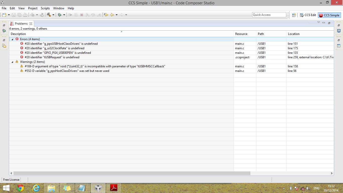

  • i have written the following code to detect a pen drive on the TIVA C TM4C123GH6PMI (configured as a USB host). I'm getting errors for undefined identifiers on CCS v6.
    Please help in resolving the issues.
    //TM4C123GH6PMI USB Host functionality // Basic configuration as a host- mass storage programming example //The following code shows the basic setup code needed for any application that is using the USB library in host mode. The g_pui8HCDPool array which is passed to the USBHCDInit( ) is used as a heap memory for by the USB library and thus should not be used by the application. In this example, the g_ppsHostClassDrivers array holds the MSC (mass storage class) drivers. The macros provided in the pin_map.h file included with DriverLib can be used to indicate which pin and peripheral to use for a given part. The USBHCDRegisterDrivers( ) call passes in the static array of supported USB host class drivers that are supported by the application. Typically, the reading or writing to a device is left to a file system layer or through direct read and write calls. #include "inc/tm4c123gh6pm.h" #include <stdint.h> #include <stdbool.h> #include "driverlib/gpio.h" #include "inc/hw_gpio.h" #include "driverlib/sysctl.h" #include "inc/hw_sysctl.h" #include "inc/hw_types.h" #include "inc/hw_memmap.h" #include "driverlib/debug.h" #include "driverlib/rom.h" #include "driverlib/pin_map.h" //#include "packages/xdc/std.h" //#include "packages/xdc/runtime/System.h" #include "driverlib/usb.h" #include "inc/hw_usb.h" #include "usblib/host/usbhost.h" //contains host mode function prototypes and data types #include "usblib/host/usbhmsc.h" //contains Mass Storage Class definitions specific to hosts #include "usblib/usblib.h" #include "usblib/usbmsc.h" //***************************************************************************** // // The error routine that is called if the driver library encounters an error. // //***************************************************************************** #ifdef DEBUG void __error__(char *pcFilename, uint32_t ui32Line) { } #endif //******************************************************************************************************************************** #define HCD_MEMORY_SIZE 128 //the size of the host controller’s memory size in bytes unsigned char g_pui8HCDPool [HCD_MEMORY_SIZE]; //the memory pool to provide to the host controller driver static tUSBHostClassDriver const * const g_ppsHostClassDrivers[] = { &g_sUSBHostMSCClassDriver }; // the global that holds all of the host drivers in use in the application static const unsigned long g_ui32NumHostClassDrivers = sizeof ( g_ppsHostClassDrivers ) / sizeof ( tUSBHostClassDriver * ); //this global holds the number of class drivers in the g_ppsHostClassDrivers list // USB MSD control #define MSD_NOT_CONNECTED 0 #define MSD_INIT 1 #define MSD_CONNECTED 2 uint32_t iMSDState= MSD_NOT_CONNECTED; //initial value 0 //************************************************************************************************************ // MSCCallBack //************************************************************************************************************* void MSCCallBack (uint32_t ui32Event) { switch (ui32Event) { // new pen drive detected case USB_EVENT_CONNECTED: { iMSDState= MSD_INIT; break; } //pen drive has been unplugged case USB_EVENT_DISCONNECTED: { iMSDState= MSD_NOT_CONNECTED; break; } } } //************************************************************************************************************* //Application Start //************************************************************************************************************** void main (void) { // const tUSBHostClassDriver * const * g_ppsUSBHostClassDrivers; // uint8_t *ptr; // Set the clocking to run from the PLL at 50 MHz SysCtlClockSet(SYSCTL_SYSDIV_4 | SYSCTL_USE_PLL | SYSCTL_OSC_MAIN | SYSCTL_XTAL_16MHZ); SysCtlUSBPLLEnable(); // enable clocking SysCtlPeripheralEnable (SYSCTL_PERIPH_USB0); //Initialize the USB stack for host mode USBStackModeSet(0,eUSBModeHost,0); //Enable the GPIO peripherals used by the USB pins SysCtlPeripheralEnable (SYSCTL_PERIPH_GPIOB); //enable PB0 and PB1 as VBUS and ID pins GPIOPinTypeUSBAnalog (GPIO_PORTB_BASE, GPIO_PIN_0 | GPIO_PIN_1); // PB0- VBUS; PB1- ID SysCtlPeripheralEnable (SYSCTL_PERIPH_GPIOL); // Enable the D+/ D- as USB pins GPIOPinTypeUSBAnalog (GPIO_PORTL_BASE, GPIO_PIN_6 | GPIO_PIN_7); // PL6- D+, PL7- D- SysCtlPeripheralEnable (SYSCTL_PERIPH_GPIOG); // configure USBEPEN as a USB pin GPIOPinConfigure (GPIO_PG4_USB0EPEN); GPIOPinTypeUSBDigital (GPIO_PORTG_BASE, GPIO_PIN_4); //***************************************************************************************************************** // LED initialization volatile uint32_t ui32Loop; SYSCTL_RCGC2_R = SYSCTL_RCGC2_GPIOF; ui32Loop = SYSCTL_RCGC2_R; GPIO_PORTF_DIR_R = 0x08; GPIO_PORTF_DEN_R = 0x08; //***************************************************************************************************************** //Register the host class drivers USBHCDRegisterDrivers (0, g_ppsUSBHostClassDrivers, g_ui32NumHostClassDrivers); // Initialize the power configuration. Set the power enable signal to be active high and does not enable the power fault. USBHCDPowerConfigInit (0, USBHCD_VBUS_AUTO_HIGH | USBHCD_VBUS_FILTER); // call any open routines here for the application to be ready for a new mass storage device tUSBHMSCInstance *g_psMSCInstance= USBHMSCDriveOpen (0, MSCCallBack); // open an instance of the mass storage class driver USBHCDInit (0, g_pui8HCDPool, HCD_MEMORY_SIZE); // initialize the host controller // main loop of the application while (1) { switch (iMSDState) { //This state is entered when the pen drive is first detected. case MSD_INIT: { //initialize the newly connected pen drive // wait for the drive to become ready- wait for the value to go to 0 before the host controller attempts to read or write from the device. while ( USBHMSCDriveReady (g_psMSCInstance)) { SysCtlDelay(g_ui32ClockRate / 100); //delay given for the device to be ready } //move it to connected state iMSDState= MSD_CONNECTED; break; } case MSD_CONNECTED: { // glow an LED if the pen drive is detected. GPIO_PORTF_DATA_R |= 0x08; for(ui32Loop = 0; ui32Loop < 200000; ui32Loop++); GPIO_PORTF_DATA_R &= ~(0x08); for(ui32Loop = 0; ui32Loop < 200000; ui32Loop++); break; } case MSD_NOT_CONNECTED: default: { break; } } USBHCDMain( ); // Periodic call for the Host Controller Drivers } }

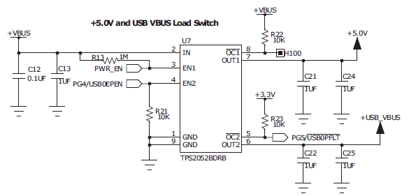

    As in TIVA TM4C123G launchpad it is configured in device mode. for configuring it in host mode is there any hardware change is required on launchpad..?
    Please let me know.
  • Hello Anupsingh,
    Yes a change is required on the EK-TM4C123 LaunchPad for providing VBUS. The following circuit needs to be added on the LaunchPad. This circuit is directly referenced from the DK-TM4C123 Schematic.
    Amit

  • Dear amit,
    We have done the following changes on the lauchpad:
    1) Populated 0 Ohm resistor at R25 and R29
    2) shorted H18 and H19 test points
    After connection there is +5V available at J9 connector. Is it sufficient or I need to do something else..? coz the pendrive is not getting detected..?
    Please help.
