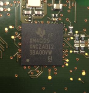

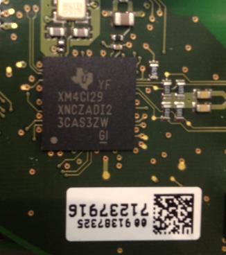

Here are my both controllers which I am using:

    on the controller with the production date 3C (see the pictures above) the PWM0 peripheral is working. Then I tried the same code on the controller with the production date 3B. There it is not working. So, my assumption was that the peripheral is not implemented in the controller.
    Tobias
  • Hello Tobias
    The devices are identical in terms of revision so the PWM0 and GPIOH should be there. The production date does not make a difference. Can you check the registers as mentioned above and the registers PPGPIO and PPPWM and send the data

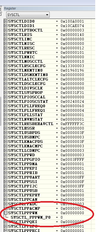

    I think I have found a reason why the PWM0 peripheral is not working on the 3B-controller. The System Control Register "Pulse Width Modulator Power Control (PCPWM)" is specified in the datasheet (TM4C129XNCZAD Rev. June 18, 2014) with a reset value of 0x0000.0001. But in my 3B-controller the reset value is 0x0000.0000, see picture of the debug interface. So the power of the PWM0 is disabled. I tried to set the bit in the register, but it didn’t worked. Maybe there is a protection.
    In the 3C-controller the reset value is 0x0000.0001.

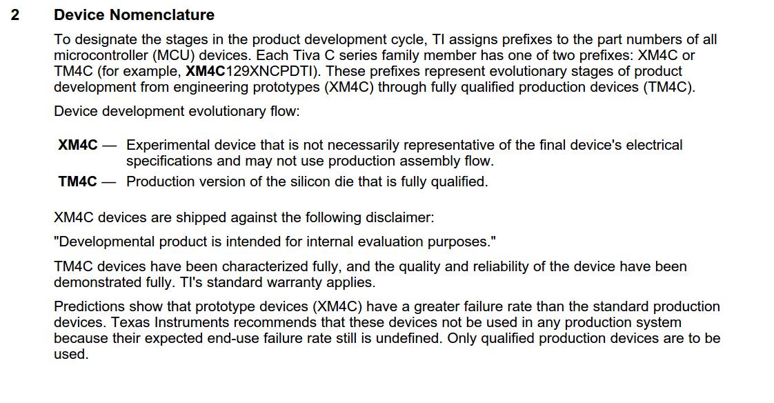

    The mark of the controller as “XM4C” means that it is an experimental device and it can have some failures, see picture. So, I do not rule out some controller failures.

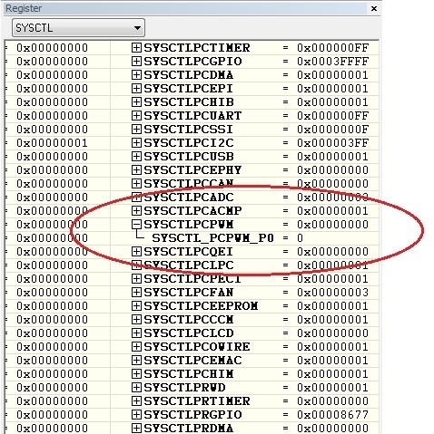

    I have found further informations, the 3B-controller do not have a PWM0 module. The system control register 56 "Pulse Width Modulator Peripheral Present (PPPWM)" is specified as follows:
    The register in the 3B-controller has the value 0, see the following register picture. The register value in the 3C-controller is set to 1. So the 3C-controller has a PWM0 and the 3B-controller not.
     Hi Tobias, WE know about nomenclature and also experimental silicon, all our initial development was on XM and also on LX Stellaris (Xperimental before to get LM aka Luminary Micro Stellaris) before ws renamed to TIVA...

  • Hello Tobias
    Clearly with the PPPWM bit 0 the PWM-0 module is not usable. However the GPIO H should still be usable as the PPGPIO for Port H is set to 1.
    Also since the device carries the XM4C marking it may not have been set to the right setting. I would suggest replacing the XM4C with the production qual-ed TM4C devices and sending the XM4C part back to TI for Fail Analysis (you may send it back to the distributor which would be returned back to us)
