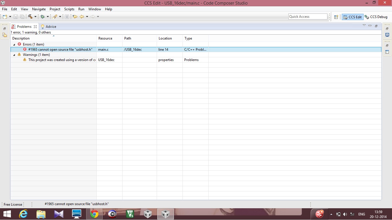

problem in USB detection with tm4c123gh6pm
this is the code i have written for configuring the microcontroller as USB host device:

i am encountering the following error

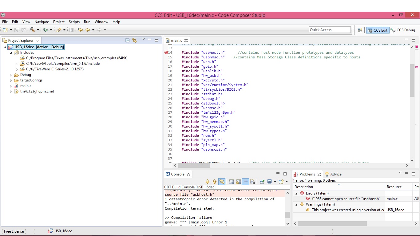

The build settings i have updated are as follows
Please help me understand this error.
      There are USB examples at Tivaware, compare it to your code.
    surabhi bhosale said:
    #include "usbhost.h"
       Try these below instead.
    #include "usblib/host/usbhost.h"
    #include "usblib/host/usbhmsc.h"
       Regarding your Build Warning Message, you can adjust Compiler Version at Project Properties->General->Compiler Version. Adjust Compiler Version to TI v5.1.5.
