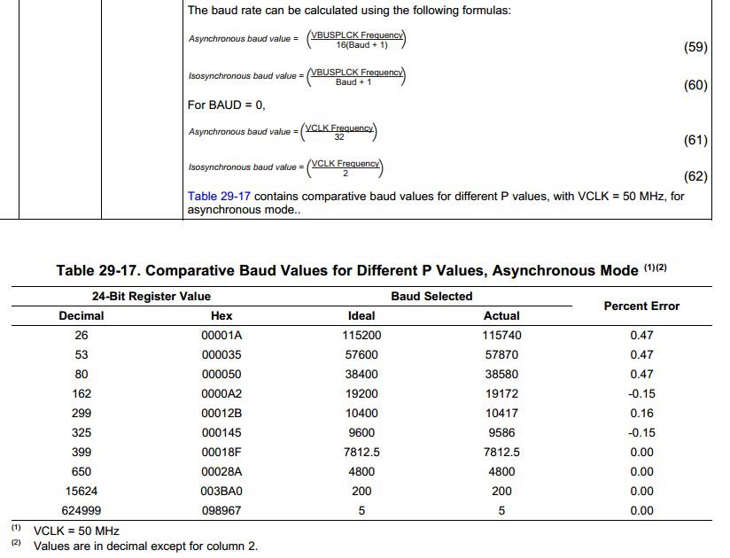

I am trying to verify if the prescaler value calculate by sciSetBaudrate() is correct, but I could not get it right, so I am wondering if I calculate it wrongly.
Lets use RM46x as an example.
In RM46x Technical Reference Manual page 1547 it shows the formulas and result sample as following picture:-
The function sciSetBaudrate() generated by HalCoGen is as follow:-

Lets try calculate the prescaler value using the same criteria in result sample with the formula in sciSetBaudrate():-
f = 16
baud = 115200
vclk = 50000000
temp = (f*(baud + 1U)) = 16*(115200 + 1) = 1843216
temp2 = ((vclk)/((float64)temp)) = 50000000/1843216 = 27.1265
sci->BRS = (uint32)((uint32)temp2 & 0x00FFFFFFU) = 27
Which the prescaler value calculated by sciSetBaudrate()(27) is different with the manual(26).
Which part did I calculate wrongly?
