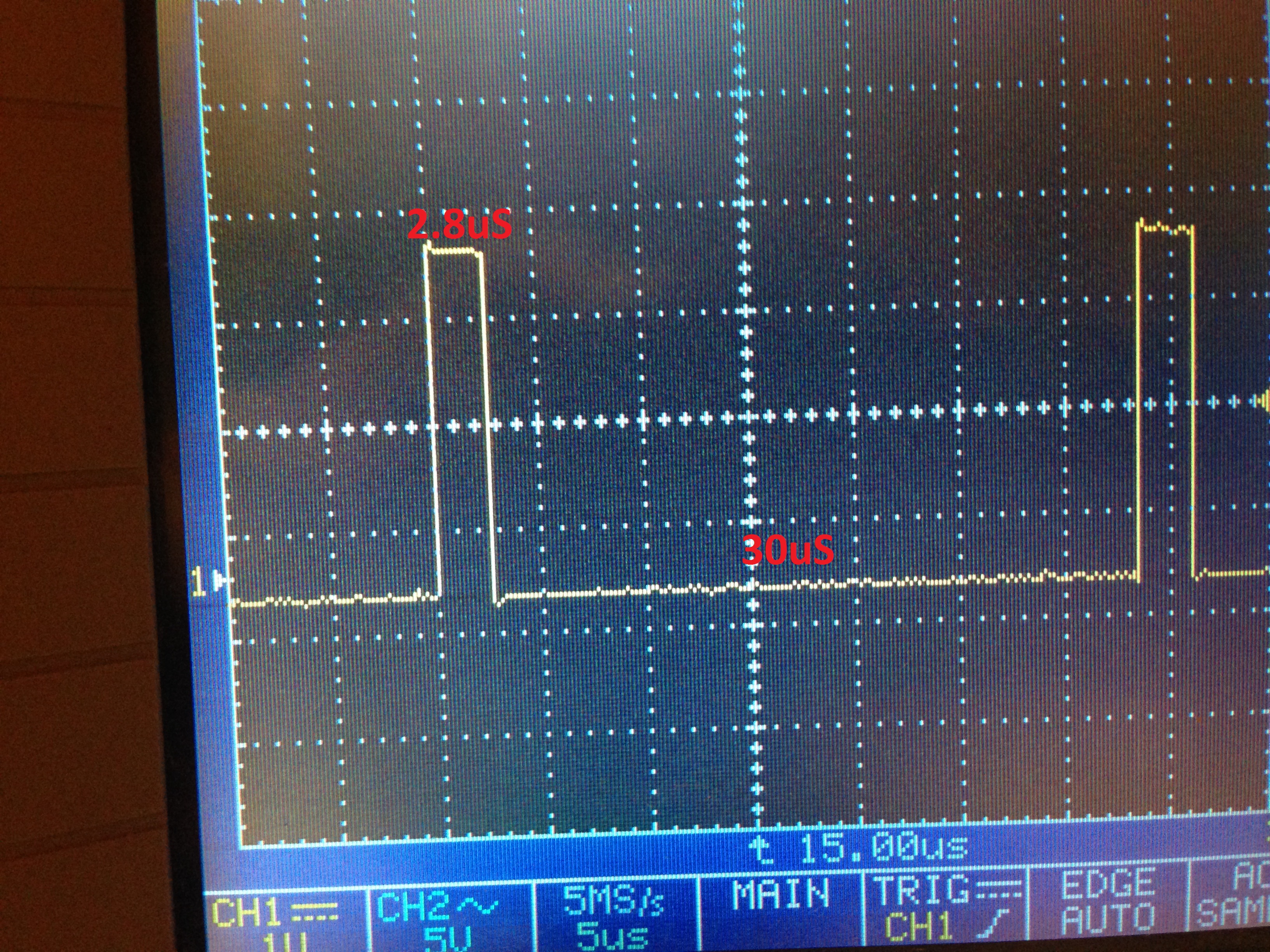

TM4C123BH6PZI, PORT D, PIN 7, GPIO Input: Edge Interrupt does not work
Hi All,
Here is signal which comes to PORT D, Pin 7 of the MCU
Here is code for MCU/GPIO setup:
main(void)
  ROM_FPULazyStackingEnable();
//on-board OSC 25MHz, MCU - 80MHz
  ROM_SysCtlClockSet(SYSCTL_SYSDIV_2_5 | SYSCTL_USE_PLL | SYSCTL_XTAL_25MHZ | SYSCTL_OSC_MAIN);
  ROM_SysCtlPeripheralEnable(SYSCTL_PERIPH_GPIOD);// Enable port D
  ROM_GPIOPinTypeGPIOInput(GPIO_PORTD_BASE, GPIO_PIN_7);
  GPIOPadConfigSet    ( GPIO_PORTD_BASE,// Enable weak pullup resistor for PD7
                          GPIO_PIN_7,
                          GPIO_STRENGTH_2MA,
                          GPIO_PIN_TYPE_STD_WPU);
  GPIOIntDisable       (GPIO_PORTD_BASE, // Disable interrupt
                          GPIO_PIN_7);
  GPIOIntClear        (GPIO_PORTD_BASE, // Clear pending interrupts
                         GPIO_PIN_7);
  GPIOIntRegister     (GPIO_PORTD_BASE, // Register our handler function for port of D channel
                         IntDRDY);
  GPIOIntTypeSet      (GPIO_PORTD_BASE, // Configure  for falling edge trigger
                         GPIO_PIN_7,
                         GPIO_BOTH_EDGES);//GPIO_LOW_LEVEL);//GPIO_BOTH_EDGES);
  GPIOIntEnable       (GPIO_PORTD_BASE, // Enable interrupt for the port
                         GPIO_PIN_7);
while(1){};
and here is interrupt handler
void
IntDRDY(void){
      uint32_t ui32Value;
      ui32Value = GPIOIntStatus(GPIO_PORTD_BASE, true);
      if (GPIOIntStatus(GPIO_PORTD_BASE, false) & GPIO_PIN_7) { //check
        //GREEN LED on
        ROM_GPIOPinWrite(GPIO_PORTA_BASE, GPIO_PIN_2, GPIO_PIN_2);
        GPIOIntClear(GPIO_PORTD_BASE, GPIO_PIN_7);  // Clear interrupt flag (!)
                                                    // if not clear interrupt call continuosly
the interrupt handler executes only when GPIO_LOW_LEVEL is set,  GPIO_FALLING_EDGE/GPIO_RISING_EDGE/GPIO_BOTH_EDGES/GPIO_HIGH_LEVEL do not work.
What could be wrong?
Thanks for any advice!
  • Hello Vasiliy,
    Please have a look at the post
    http://e2e.ti.com/support/microcontrollers/tiva_arm/f/908/t/374640
    Amit
  • Thanks! It works now!

  • Yes, I agree with you and add here work around for next readers. To solve issue just add extra code after peripheral enable and before irq init:
    // unlock Port D, Pin 7 (DRDY): http://e2e.ti.com/support/microcontrollers/tiva_arm/f/908/t/374640
    HWREG(ADC_RST_DRDY_PORT+GPIO_O_LOCK) = GPIO_LOCK_KEY;
    HWREG(ADC_RST_DRDY_PORT+GPIO_O_CR) |= ADC_DRDY_PIN;
