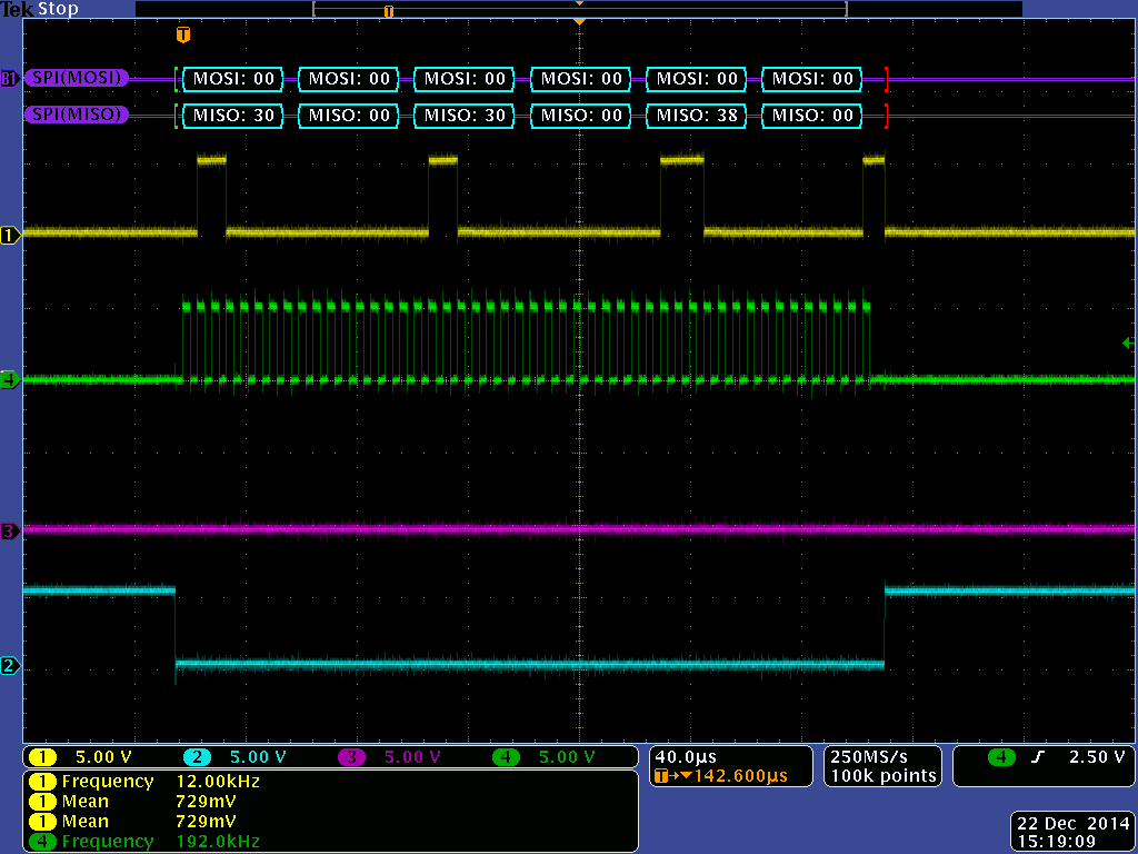

I have Tiva tm4c1231h6pge, and I have programmed SSI2 and DMA as follow:

// DMA is correctly initialized ROM_SSIDMAEnable(SSI2_BASE, SSI_DMA_TX); ROM_uDMAChannelAssign(UDMA_CH13_SSI2TX); ROM_uDMAChannelAttributeDisable(UDMA_CHANNEL_SSI2TX, UDMA_ATTR_ALTSELECT | UDMA_ATTR_HIGH_PRIORITY | UDMA_ATTR_REQMASK); ROM_uDMAChannelAttributeEnable(UDMA_CHANNEL_SSI2TX, UDMA_ATTR_USEBURST); ROM_uDMAChannelControlSet(UDMA_CHANNEL_SSI2TX | UDMA_PRI_SELECT, UDMA_SIZE_8 | UDMA_SRC_INC_8 | UDMA_DST_INC_NONE | UDMA_ARB_4); ROM_uDMAChannelTransferSet(UDMA_CHANNEL_SSI2TX | UDMA_PRI_SELECT, UDMA_MODE_BASIC, data, (void *)(SSI2_BASE + SSI_O_DR), sizeof(data)); ROM_uDMAChannelEnable(UDMA_CHANNEL_SSI2TX);
Using SSI_FRF_MODE_0 for every byte transfered FFS is asserted and deasserted:
In this screenshot cyan trace (number 2) is FSS, and green (4) is clock. the other are miso and mosi.
If I just change from SSI_FRF_MODE_0 to SSI_FRF_MODE_1 the FSS is asserted only one:
I don't know why. Is possible to have only one transacton using mode 0?

  • Hello Max,
    Please refer to the datasheet chapter for SSI. In Frame format 0, for continuous transfer the FSS shall be pulsed but in Frame format 1 it will be held low.
    Amit
    It appears that your desire may be met (under mode 0) - by freeing FSS from its SPI controlled operation - and toggling (as needed) while FSS (alone) is ordered as ordinary GPIO.  This forces bit more care/thought upon you - yet may best meet your requirement - as registered herein...
