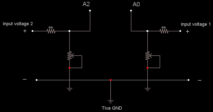

    I use TIVA  TM4C1294XL launchpad as a multichannel voltometer with sending data through UDP protocol and displaying on LCD. Problem was very similar to that one described by Makarand Deshmukh
    I use simple voltage divider. Diagram below shows circuit.
    When I connected input voltage 1 (5.3V) (number 2 was disconnected) result  was OK ( Voltage 1: 5.3V  ;  Voltage 2 :0.0V )
    When I connected input voltage 2 (5.3V) (number 1 was disconnected) result  was only partialy OK ( Voltage 1: 0.53V  ;  Voltage 2 :5.3V )
    When I connected both inputs (5.3V) result  even more strange ( Voltage 1: 6.02V  ;  Voltage 2 :6.03V )
    I tried to change inputs on launchpad result was the same or even worse (One input always had influence on second one)
    But Yesterday I figured out what was wrong. It is problem with computer power supply. All voltages are stable and have proper levels but it generate some noise which affect the work of ADC.
    When I connected Launchpad to my old good DELL D630 laptop... measures are very stable and one channel doesn't affect on the other. So my problem is resolved
