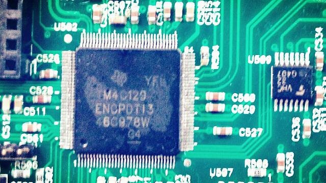

  • Hi, Amit Ashara
    Thanks your help, I follow your suggestion, use 16KB erase(128 bytes), and CCS shows FaultISR again...
    The following picture is my cpu, I hope it will be helpful to you.
  • Hello Tu,
    Thanks for the image. That will help me narrow down my search on any know issue.
    If you replace the ROM_FlashErase with FlashErase does it behave the same manner. (I would be able to run a sample code to execute code from lower 512K and ROM_FlashErase upper 512KB only tomorrow, so may be this can help you to WA the issue)
    Also, what I did notice was that the code execution faulted at 0x7ADC4 which means that there is code in the higher region of the lower 512KB of flash. Could it be possible that there is an interrupt which caused the CPU to go to 0x80000+ region and hence result in a fault?
