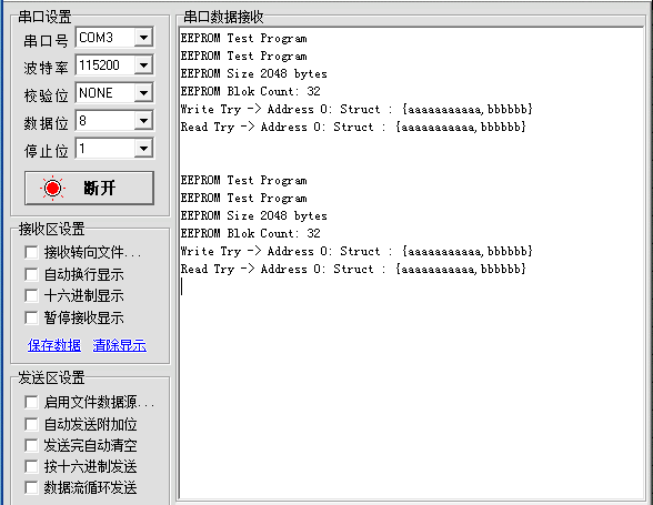

    My part of the code is defined as follows:
    struct E2PROM
           char *value;
           char *ss;
    struct E2PROM e2prom_write_value = {"aaaaaaaaaaa","bbbbbb"};
    struct E2PROM e2prom_read_value =  {"",""};
    UARTprintf("Write Try -> Address %u: Struct : {%s}\n", E2PROM_TEST_ADRES, e2prom_write_value.value);
    EEPROMProgram((uint32_t *)&e2prom_write_value, E2PROM_TEST_ADRES, sizeof(e2prom_write_value));
    EEPROMRead((uint32_t *)&e2prom_read_value, E2PROM_TEST_ADRES, sizeof(e2prom_read_value));
    UARTprintf("Read Try -> Address %u: Struct : {%s,,%s}\n", E2PROM_TEST_ADRES,e2prom_read_value.value,e2prom_read_value.ss);
    When I put the code into the red blue ,but  outputs the result is the same , which is the result of what causes?
    EEPROMProgram((uint32_t *)&e2prom_write_value, E2PROM_TEST_ADRES, 16);
    EEPROMRead((uint32_t *)&e2prom_read_value, E2PROM_TEST_ADRES, 16);

  • Hello Lewis,
    What is the output of the UARTprint that you get on a terminal. Can you please send that as well?
    Amit
  • Hello Lewis,
    Your EEPROM Code is working fine since what you write is what you will get from EEPROM if the same address and size is used for EEPROMRead as EEPROMProgram.
    As I mentioned earlier the EEPROM stores upto 6144 bytes (1536 words). So the Start and End Address have to be in the same range,
    Amit
