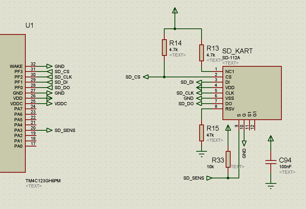

Hi;
I want to use sdcard with SSi1 prepheral. Sdcard can mount but I get "New file creation error". What is the problem ?

  • Hello Metin
    PF0 is a locked pin and needs to be unlocked before any configuration. Please see the following post.
    http://e2e.ti.com/support/microcontrollers/tiva_arm/f/908/t/374640
    Amit
  • I made it , Nothing changed :/
  • Hello Metin
    Is this a custom board? If yes can you share the schematic. Also are you using the software example for sd_card in TivaWare and share the modifications/code for the same
    Amit

    It is custom board.  Schematic is here:
    And I check CCLK signal with osciloscope , No clock signal !
  • Hello Metin,
    The FSS pin has to be configured as a GPIO and not as SSI Controlled Pin. So the following line
    GPIOPinConfigure(GPIO_PF3_SSI1FSS);
    must be replaced by
    GPIOPinTypeGPIOOutput(SDC_GPIO_PORT_BASE, SDC_SSI_FSS);
    Are you making the changes in the mmc-dk-tm4c123g.c file or in the main code?
    Amit
  • I dont change anything, it is written in mmc-dk-tm4c123g.c File.
  • Hello Metin,
    But what about the code post mentioned above along with the schematics? If you can share your CCS project, I could be able to help you out.
    Amit

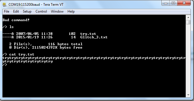

  • Hello Metin,
    I reused the sd_card code on DK-TM4C123GXL to create new files and write to them and it works fine. Maybe you can check the framework and reuse the same (or send in the project)
    int

    Amit

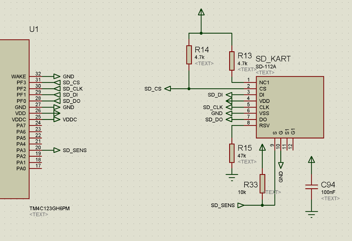

  • Yes, I transfer pins SSI0 to SSI1 and schematic is this.
  • Hello Metin,
    The schematic is correct and so are the connections. I would suggest connecting a scope probe to see what is happening on the signals when the f_mount is called.
    Amit
  • Hello Amit;
    Nothing is changed. Clock -> Zero , FSS -> High , Tx -> Low , Rx-> High, And f_mount is returning FR_OK
