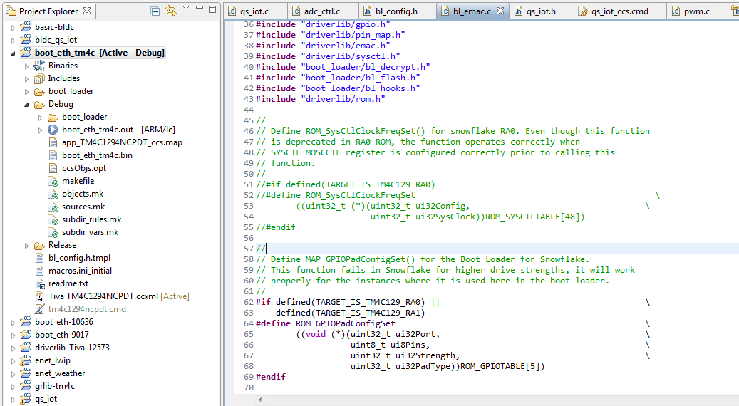

Revisiting software Boot Loader have now fixed a few fatal issues that were keeping it in DOA status at least with Rev 1 silicon. The DID0 register will reveal Rev1 silicon in your chip can be made to split hairs with EBL performing some magic tricks.
The SYSCLK was killed by a patch now (commented out) , Bamboozled CCS5 ICDI debug simulator. No Hexadecimal decode for instructions show in the disassembly window for the source listings.

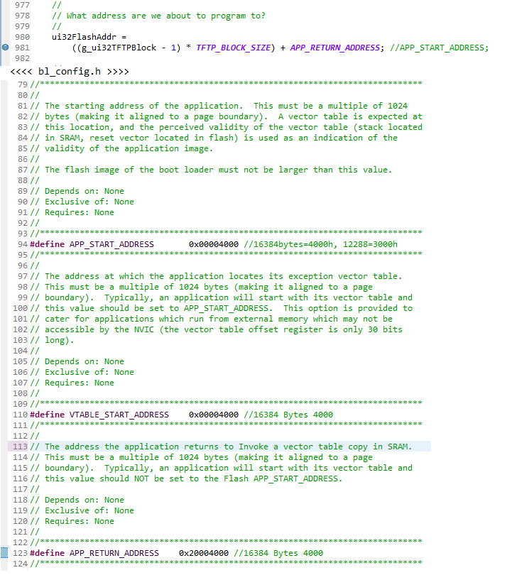

Debug: Shown top is (bl_emac.c) and the addition of an (Application Return Address). Found the TFTP data transfer & Flash loads into SRAM avoids writing flash memory corrupting the Application and Boot loader.

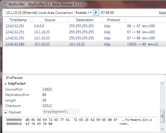

Packet Sniffer trace shows what appears to be a file name header sent from the TFTP client back to the server.
Sniffer fails to capture the flash image 512 byte blocks in packets being transferred.

  • Above test there is actually no data being Flashed into SRAM, simulates the TFTP file handling protocol.
    Possibly the Flash code is not working correctly, flashing (APP_START_ADDRESS) mangles both the Boot Loader & Application.
    The application asserts the bool switch invoking Boot Loader from a function command. Code below for anyone wanting their application to invoke the Tiva Software Boot Loader. The Boot Loaders assigned bootp server port (67) via embedded GUI must initiate a firmware upgrade from the listening bootp client port (68) sending packets from the (*.bin) file to be flashed as blocks via TFTP server port (69). Asserting a Boot Loader Reset command then invokes the flashed application at (APP_START_ADDRESS).
