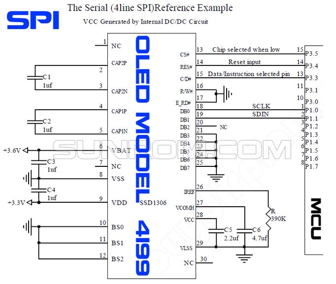

  • @Roberto,
    Thank you Roberto - w/out your link many here would not learn that this OLED (includes) the "auxilliary pcb" to ease display interconnect AND to provide the boost voltage - always required by this type display.
    Thus - issue reduces to proper interconnect and SPI SW - should be straightforward.
    As stated previously (this reporter) potential users of this display will, "Pay thru the nose" for the ease of connection & boost supply components/connections.   (linked web-site indicates ~9 (USD) @ 100 pcs.   "Usual" OLED (this size/type) would cost ~3 (USD) - minus that auxilliary board!  And - of course - the OLED is unlikely to be available (alone, from this linked vendor) which would allow volume users to build the needed/add on components upon their "normal" pcb.
    Thanks Roberto for doing this "digging."   From experience - these are nice OLEDs - packaged as it is provides a convenience - yet users pay dearly...

  • For those (potentially) interested in this/other OLEDs - here find the normal/customary "added component" requirements to generate the necessary boost voltage.
    (credit Sunrom - this diagram)
    Poster did not detail that his was an OLED module - complete w/added pcb.  Those added boost components and routings are resident upon that "extra" pcb. OLEDs will not operate w/out the proper boost voltage.

  • void OLED_Initialization( void);
    int main(void)
             //Initializes the OLED
      	  OLED_Initialization();
    	  GrContextInit(&sContext, &g_sCFAL96x64x16);
    	  GrContextForegroundSet(&sContext, ClrWhite);
              GrRectDraw(&sContext, &sRect);
    	  GrContextFontSet(&sContext, g_pFontCm12);
              GrStringDrawCentered(&sContext, "Hello", -1,
                             GrContextDpyWidthGet(&sContext) / 2, 6, 0);
    Subroutine:  OLED_Initialization
    parameters:  None
    Returns:     None
    Synopsis:    Oled Initiazation and displays "Testamatic Sys" and "RAS" on Oled
        //System clock set 50MHZ
          SysCtlClockSet(SYSCTL_SYSDIV_4 | SYSCTL_USE_PLL | SYSCTL_XTAL_16MHZ |
                           SYSCTL_OSC_MAIN);
        //SPI initialization
          CFAL128x64Init();
       //Graphical display initialization
  • Hi Nethra, I am sorry say, as we discussed about with CB1,  OLED module you choosed cannot apply minimal GRLIB requirement.
    Your module also if two color "zones" are on display area classify as Black/White or monochrome device. GRLIB require an RGB device and I fear this cannot be attached to GRLIB. I have no experience with and I never plan use Monochrome devices due TFT now  cost less or equals to Monochrome.
    I don't remember where I read it require RGB, from GRLIB driver reference 1bpp can be inmplemented too, funtion translate ccolor must return 1 or 0 if pixel has to be set on or off. Example driver propose use color as threshold so black is black and every color just 1 over black is white, better can be some threshold based on sum of R G B level and set when mid bright trespass.
     http://www.ti.com/lit/an/spma055/spma055.pdf?keyMatch=grlib&tisearch=Search-EN
  • nethra patil said:
    //***************************************************************************** // // Translates a 24-bit RGB color to a display driver-specific color. // // \param c is the 24-bit RGB color. The least-significant byte is the blue // channel, the next byte is the green channel, and the third byte is the red // channel. // // This macro translates a 24-bit RGB color into a value that can be written // into the display's frame buffer in order to reproduce that color, or the // closest possible approximation of that color. // // \return Returns the display-driver specific color. // // 24-bit format: XXXX XXXX RRRR RRRR GGGG GGGG BBBB BBBB // 16-bit format: ---- ---- ---- ---- RRRR RGGG GGGB BBBB // 8-bit format: ---- ---- ---- ---- ---- ---- RRRG GGBB // // //***************************************************************************** #define DPYCOLORTRANSLATE16(c) ((((c) & 0x00f80000) >> 8) | \ (((c) & 0x0000fc00) >> 5) | \ (((c) & 0x000000f8) >> 3)) #define DPYCOLORTRANSLATE8(c) ((((c) & 0x00e00000) >> 16) | \ (((c) & 0x0000e000) >> 11) | \ (((c) & 0x000000c0) >> 6)) #define DPYCOLORTRANSLATE DPYCOLORTRANSLATE8
     Hi, this function need to be customized,
     TI propose on 1bpp example just return 0 if c==0 1 if c!=1, this is an extreme contrast setting, so I try propose use a less extreme solution like:
    #define DPYCOLORTRANSLATE1(c) ( ( (((c) & 0x00ff0000) >> 16) +                  \  // red value +
                                      (((c) & 0x0000ff00) >> 8) |                  \ // green value +
                                     ((c) & 0x000000ff))  \  // blue value
    > 350) ? 0 : 1)
    #define DPYCOLORTRANSLATE DPYCOLORTRANSLATE1

    //! CFAL9664-F-B1 OLED panel with SSD 1332 controller.
    const tDisplay g_sCFAL96x64x16 =
        sizeof(tDisplay),
        0,
        128,
        64,
        CFAL96x64x16PixelDraw,
        CFAL96x64x16PixelDrawMultiple,
        CFAL96x64x16LineDrawH,
        CFAL96x64x16LineDrawV,
        CFAL96x64x16RectFill,
        CFAL96x64x16ColorTranslate,
        CFAL96x64x16Flush
    //! Initializes the display driver.
    //! This function initializes the SSD1332 display controller on the panel,
    //! preparing it to display data.
    //! \return None.
    void
    CFAL96x64x16Init(void)
        tRectangle sRect;
        // Enable the peripherals used by this driver
        ROM_SysCtlPeripheralEnable(DISPLAY_SSI_PERIPH);
        ROM_SysCtlPeripheralEnable(DISPLAY_SSI_GPIO_PERIPH);
        ROM_SysCtlPeripheralEnable(DISPLAY_RST_GPIO_PERIPH);
        // Select the SSI function for the appropriate pins
        ROM_GPIOPinConfigure(DISPLAY_PINCFG_SSICLK);
        ROM_GPIOPinConfigure(DISPLAY_PINCFG_SSIFSS);
        ROM_GPIOPinConfigure(DISPLAY_PINCFG_SSITX);
        // Configure the pins for the SSI function
        ROM_GPIOPinTypeSSI(DISPLAY_SSI_PORT, DISPLAY_SSI_PINS);
        // Configure display control pins as GPIO output
        ROM_GPIOPinTypeGPIOOutput(DISPLAY_RST_PORT, DISPLAY_RST_PIN);
        ROM_GPIOPinTypeGPIOOutput(DISPLAY_ENV_PORT, DISPLAY_ENV_PIN);
        ROM_GPIOPinTypeGPIOOutput(DISPLAY_D_C_PORT, DISPLAY_D_C_PIN);
        // Reset pin high, power off
        ROM_GPIOPinWrite(DISPLAY_RST_PORT, DISPLAY_RST_PIN, DISPLAY_RST_PIN);
        ROM_GPIOPinWrite(DISPLAY_ENV_PORT, DISPLAY_ENV_PIN, 0);
        ROM_SysCtlDelay(1000);
        // Drive the reset pin low while we do other stuff
        ROM_GPIOPinWrite(DISPLAY_RST_PORT, DISPLAY_RST_PIN, 0);
        // Configure the SSI port
        ROM_SSIDisable(DISPLAY_SSI_BASE);
        ROM_SSIConfigSetExpClk(DISPLAY_SSI_BASE, ROM_SysCtlClockGet(),
                               SSI_FRF_MOTO_MODE_3, SSI_MODE_MASTER,
                               DISPLAY_SSI_CLOCK, 8);
        ROM_SSIEnable(DISPLAY_SSI_BASE);
        // Take the display out of reset
        // Enable display power supply
        ROM_GPIOPinWrite(DISPLAY_ENV_PORT, DISPLAY_ENV_PIN, DISPLAY_ENV_PIN);
        // Send the initial configuration command bytes to the display
        CFAL96x64x16WriteCommand(g_ucDisplayInitCommands,
                                 sizeof(g_ucDisplayInitCommands));
        // Fill the entire display with a black rectangle, to clear it.
      //  sRect.i16XMin = 0;
        //sRect.i16XMax = 95;
        //sRect.i16YMin = 0;
        //sRect.i16YMax = 63;
        //CFAL96x64x16RectFill(0, &sRect, 0);
    		lcd_clear();
    		while(1)
    			switch(demo_screen)
    				case 0:
    					demo_fill_screen();
    					demo_screen=1;
    					break;
    				case 1:
    					lcd_clear();
    					demo_font_small();
    					demo_screen=2;
    					break;
    				case 2:
    					//lcd_send_command(SSD1306_INVERTDISPLAY);
    					CFAL96x64x16WriteCommand(SSD1306_INVERTDISPLAY, sizeof(SSD1306_INVERTDISPLAY));
    					demo_screen=3;
    					break;
    				case 3:
    					//lcd_send_command(SSD1306_NORMALDISPLAY);
    					CFAL96x64x16WriteCommand(SSD1306_NORMALDISPLAY, sizeof(SSD1306_NORMALDISPLAY));
    					demo_screen=4;
    					break;
    				case 4:
    					lcd_test_picture();
    					demo_screen=5;
    					break;
    				case 5:
    					demo_screen=6;
    					break;
    				case 6:
    					demo_screen=0;
    					break;
    		//_delay_ms(2000);	// every 2 second the demo screens stays before change
    			ROM_SysCtlDelay(2000);
    // Close the Doxygen group.
    Hey Roberto I tried modifying the Example AVR  code to ARM, Its working fine,I am able to get my correct display.The code I pasted above for the same.
    But my doubt is , if I use the TI graphical library (by modifying it) , does it works for the 128x64 OLED (ssd 1306)? Or which routines I need to modify in grlib?
