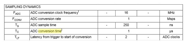

  • According to datasheet, if I set system clock 16 Mhz then only for 1msps setting, conversion time will be 1us.
    What will be conversion time if I set System clock 40 Mhz, 1msps setting..?? OR
    What will be conversion time if I set System clock 80 Mhz, 1msps setting..??
  • Hello Krishnat
    Execution time would be inversely proportional to the system clock frequency. However for system frequency above 40MHz the prefetch buffer would slow down the execution slightly.
