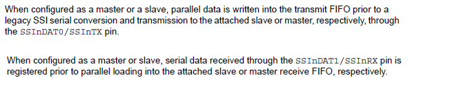

  • Hello Peter, cb1
    Following is the data sheet section from the Transmit and Receive FIFO section of the SSI Chapter...
    Otherwise as what Peter mentioned the SSI Master is transmitting the data but the Slave is reading all 0's. To double check the point. If the Master RX pin is made high by the use of Internal Pull Up, it should start receiving all 1's!!!

  • Amit, the text you quoted from the published datasheet suggests that the MOSI pins are different on the slave and master !! Likewise the MISO pins are different too.
    up until now MOSI was always Tx and MISO always Rx on BOTH slave and MASTER as per cb1's reinforcement above (which I just note he retracted in a mea culpa !!)
    CAN YOU CONFIRM THE MOSI and MISO PINS ARE DIFFERENT ON THE SLAVE AND MASTER for TM4C129X ?
    CAN YOU ALSO CONFIRM that I therefore should connect:
    • MOSI:  Master SSInXDAT0  to Slave SSI0nDAT1  and
    • MISO:  Master SSI0nDAT1  to Slave SSInXDAT0
    If so then this is contrary to how I have it wired as per my initial post and I must reverse the wiring !!!! :(
  • Hello Peter
    Yes, I can confirm the same looking at the data sheet and based on an old code for TM4C129. To re-create the setup I would have to wait till Monday
    Amit
  • Thanks Amit. No need to recreate the setup, as your understanding is sufficient to convince me what is wrong.
    This was truly a trap, breaking a long standing convention that with SSI, the Tx Master gets connected to the Tx Slave !! now it is back to how UARTs get connected Tx->Rx !

    a. As I suggested earlier if you can make the master RX Pin as a GPIO Output and drive 1, see that the Slave gets a all 1's pattern and confirm. This way you would not cut-wire the PCB to test.
    b. This is clearly a documentation issue to me and I need to add an errata clarifying the pin convention for Slave clearly and master clearly as it does violate the understanding of MOSI and MISO.

  • Forcing PQ3 (was SSI3XDAT1) to be high resulted in the slave reading all 1's rather than 0's. This confirms the problem was indeed reversed data lines between the slave and master. I blame the datasheet as it wasn't sufficiently clear that legacy SSI needs the master and slave pins swapped contrary to convention.
    My colleague even recommended the datasheet contains a diagram showing the master and slave with the Tx and Rx lines joined for legacy SSI.
    Thanks again cb1 and Amit for your help on this.
    As for our way forward, it seems Bi-SSI will have additional transaction overhead because its bus is max 8 bits wide not 16 bits. furthermore it might take us slightly longer to refactor our code to work with 8 bit data instead of 16 bit compared to re-wiring the lines so it is less risky to swap the lines on the schematic for the non prototype PCB release.
