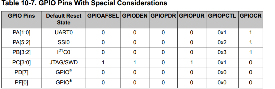

Hi all
MCU: TM4C1231C3PM
KEIL: keil5.0
I now want to use PB[3:2] as GPIO Function,but the table above shows the default state is not GPIO function.
How should I configure them?

Lewis said:want to use PB[3:2] as GPIO Function
Let me begin by commending you for having the discipline to read/review the GPIO Section of your MCU manual. (too many do not)
It's normal/customary for (most) MCU pins to default into GPIO (input) mode. As you observe - PB3/PB2 break that path - but should respond via the function call:
"GPIOPinTypeGPIOInput() or GPIOPinTypeGPIOOutput()." You're responsible for adding - both Port & Pin parameters - to complete those 2 calls.
Note that call, "GPIOPinConfigure()" is (not) required for GPIO destined pins. (but is required for most other - pin configurations.)
Again - nice "get" and you appear very well, "on your way."

I'm pleased that you confirmed my guidance - especially that you detailed that (all 3 Regs) GPIODEN, GPIOAFSEL, & GPIODIR are nicely managed via the extremely efficient call "GPIOPinTypeGPIOx()" (where x must be replaced w/Input or Output.
Thus this call "GPIOPinTypeGPIOx()" - in "one go" - saves the time/effort and (always) uncertainty which results from posters' use of Direct Register...
Hi all
ROM_SysCtlPeripheralEnable(SYSCTL_PERIPH_GPIOB);
HWREG(GPIO_PORTB_BASE + GPIO_O_LOCK) = GPIO_LOCK_KEY;
HWREG(GPIO_PORTB_BASE + GPIO_O_CR) = 0x04;
HWREG(GPIO_PORTB_BASE + GPIO_O_AFSEL) &= 0xfb;
HWREG(GPIO_PORTB_BASE + GPIO_O_CR) = 0x08;
HWREG(GPIO_PORTB_BASE + GPIO_O_AFSEL) &= 0xf7;
ROM_GPIOPinTypeGPIOOutput(GPIO_PORTB_BASE, 0xFF);
ROM_GPIOPinWrite(GPIO_PORTB_BASE, 0xFF,addr);
May I ask I need to add those marked in red content?

MCU manual - with some effort - reveals which pins require, "Unlock" treatment. (doubtful that PB2/3 require such treatment.)

I am very pleased to receive your reply again! I am grateful that you can answer my question. I am just beginning to learn this MCU. I saw the table, I feel very confused, and that leads me to suspect that PB [3: 2] These two pins still need a very special configuration it can be used as a normal GPIO pin (for example: PB0 / PB1, PF4 ... ...).
I now want to use the PB [0: 7] as normal (I / O function) rather than its alternate function, my code is as follows: ROM_SysCtlPeripheralEnable (SYSCTL_PERIPH_GPIOB);
ROM_GPIOPinTypeGPIOOutput (GPIO_PORTB_BASE, 0xFF);
ROM_GPIOPinWrite (GPIO_PORTB_BASE, 0xFF, addr);
If you feel there is anything wrong place or that the above code is not successful, I also ask you to help me change it?
I look forward to your reply!
Please do read again the code snippets which both vendor's Amit & I earlier supplied.
I do not believe that you need your (earlier) "red unlock" code block. Code you post now (potentially) places each/every pin w/in Port B into Output mode. (that's caused by your use of 0xFF w/in 2nd function parameter)
Usually - but not always - use of the unlock procedure is confined to those pins which serve as JTAG/SWD (usually PC0-PC3) and NMI. (PF0, PD7) Again - if you "search" for "unlock" w/in your MCU manual (one hopes) the required detail will emerge.
