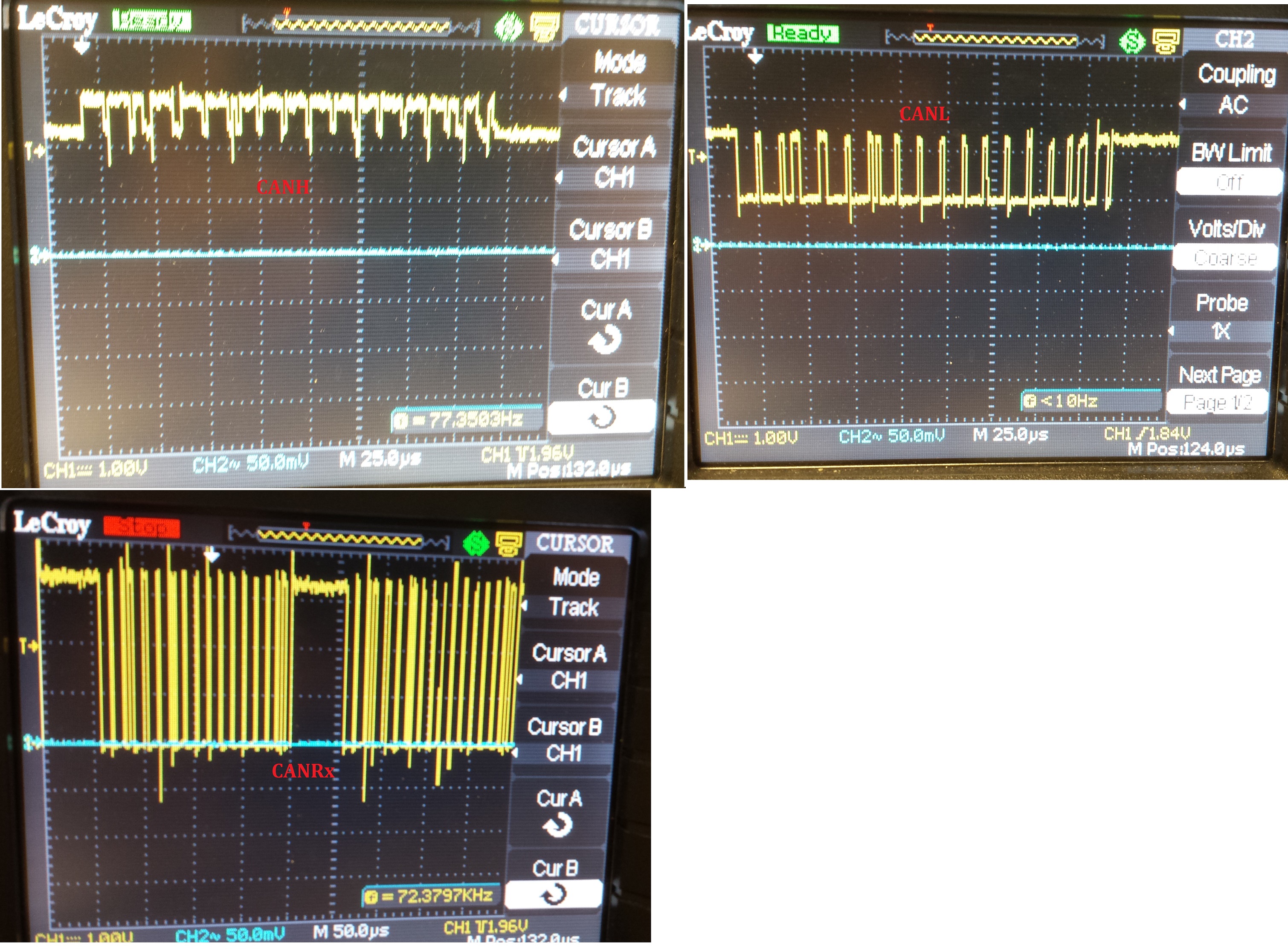

  • Ok Andrew, I understood it really hang, please connect a scope/LA to CANH and see if there is activity on bus and TX pin too.

  • What is shown is CANL (1V to 2.2V). CANH is also working (2.2V to around 3V). I only have 1 probe, so they are not on the same screen.
    I probed CAN1Rx of the RX Tiva and it seems like all its receiving is noise through its transceiver.
    The debugger says I get into an unexpected interrupt. Intdefaulthandler() gets called.
